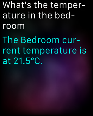

NewFolk wrote:
Thyraz wrote:Ok, to my earlier question: The Domoticzs platform shim only supports switches so far, no sensors.
Let's see if we get this hacked into the domoticz.js. :)
Siri does not support sensors.
https://support.apple.com/en-us/HT204893
That's not true.
Here's a screenshot using Elgato Eve Room and Siri on the Apple Watch:
And after looking at the FHEM shim of Homebridge I think they already support more than switches...
