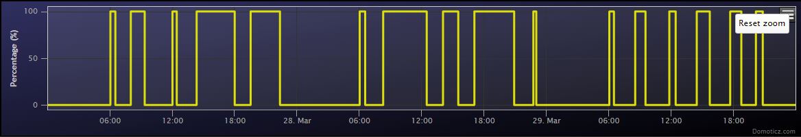

Im gonna play a llittle with the variables and see what is does to the boiler switch

Post by Skippiemanz »
Had your newest script running for 4 days now.
At first the values seemed to be stuck but after a power failure of 2 hours everything started up as planned and from that point on the values looked promissing.
Her is my overview of the Boiler on switch during 3 days.
Heatingswitch
Heatingswitch
l0gic
Posts: 107
Joined: Tuesday 08 October 2013 9:35
Domoticz version: Latest
ELV Max! Heating control system
Post by l0gic »
Well that is looking ok as a starting point.
I'm playing with the optimum values that allow me to keep the house warm without short cycling the boiler.
I think that will only really happen once the script actually controls the boiler.
Regarding your sticking values, if you look at my last post I've set up a monitor the ensure that the values are up to date.
If we rely on them for control we need accurate values.
