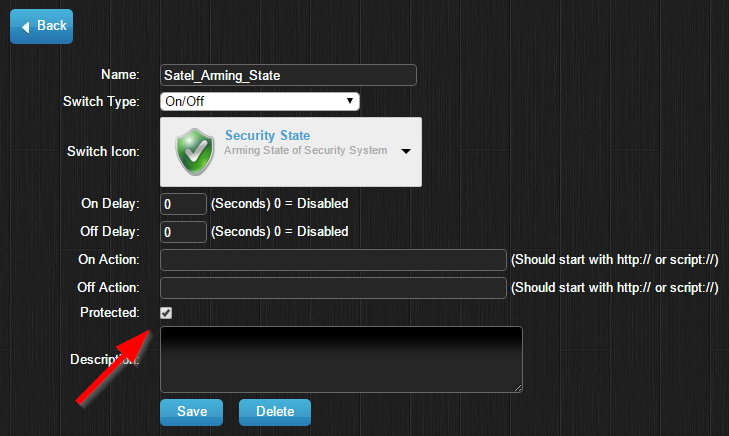

Today i develop new version.
Please download domoticz, delete hardware, allow for accept new hardware and add hardware again.

How works "protected device" ? I don't see. How i may tested it ?
Fantom

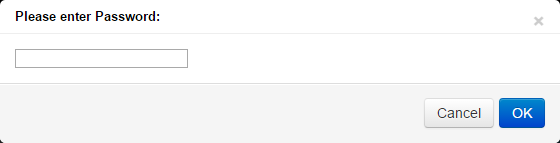

With a protected device, you get a pop-up that asks you for a code before you are able to switch it on or off. See screenshot:
Protect
Protect
2015-09-11 09_48_50-Domoticz.png (97.69 KiB) Viewed 3871 times
This is the prompt you get:
Code
Code
2015-09-11 09_51_24-Domoticz.png (4.4 KiB) Viewed 3871 times
It would be great if such a pop-up would also be able to pass the code on to the Satel when switching. This way, everyone can use it's own code when using Domoticz. Also, this way the code is not saved in the Domoticz database.
It is not a big thing but it would be just a bit more clean this way.
