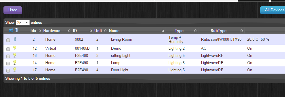

Hi All,
I hope someone can help a newbie. I have only just started to use Domoticz and I am still learning.
I understand that I need to create config.json file.
    "description": "Configuration file for Domoticz platform.",
    "platforms": [
            "platform": "Domoticz",
            "name": "Domoticz",
            "server": "127.0.0.1",
            "port": "8080"
    "accessories": [
However I am not sure if I need to include my lights(accessories) in this file? or if they are picked up once I start the program and then I configure them in the IOS app?
If I need to add them in the config file, can some one assist in showing me how I should enter these parameters. I would be most grateful.
I am using LightwaveRF devices attached is a snip from my Devices section.
Best wishes.

You do not need to add the lights in the config.json file. They will be available through Domoticz in the iOS app.
There has been a change in Homebridge recently, so I think you have to add some extra information in the config.json, see my earlier post http://www.domoticz.com/forum/viewtopic ... 864#p52627. (I have Domoticz running on my Synology NAS so therefore I am using another ip and port.)
