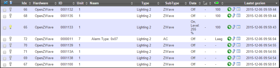

I'm having troubles with the sensor as well. See attached image where all sensor of one motion sensor are listed. Why am i not getting any further info per sensor...I really can't distinguish the sensors?

I came across this topic after I recently upgraded my Domoticz with ZWave, and got a few POPP switches and a Vision ZP3102 motion sensor.
I had to include the device a couple of times to get at least a device that represents motion. In the last inclusion I did, I got 7 devices, but though the device is said to have temp + humidity sensors as well, I never got any device that would resemble this in Domoticz.
The current list I have:
I altered the initially called 'Burglar' to ZWMotion1 and changed the type to a motion sensor. However, all the other devices are reported as Lighting2 devices, from which I don't know how to get a temperature value.
Any ideas on this? And what all other devices actually do or how to use these?
Gerco
Gerco

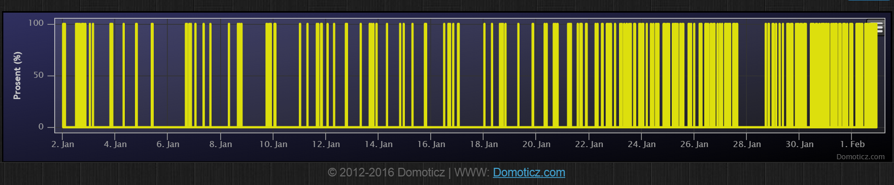

A have a new problem with this sensor, it start to detect motion that don't exist, more and more often.
Logg (from 18:50 today):
