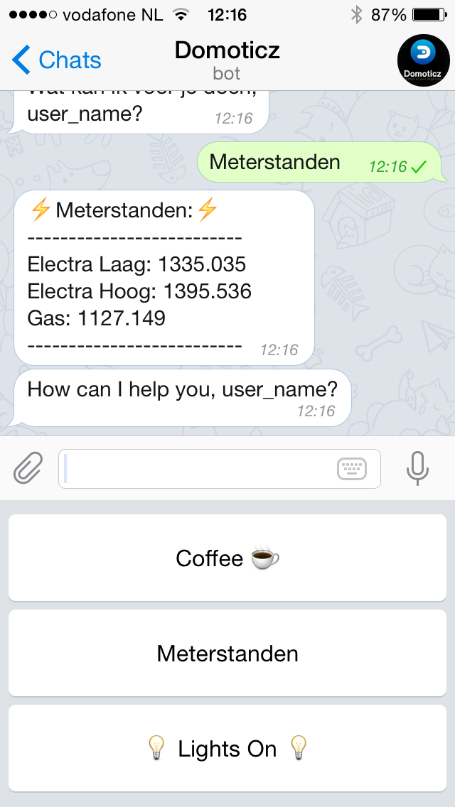

Here a little example from my custom keyboard. This is a code in bash I put at the end of every bash script. The "id=" extract the username who asked for a command. So it says: How can I help you, user?
id=`curl --data 'chat_id='$SendMsgTo --data-urlencode 'text='"$ResultString" 'https://api.telegram.org/bot'$TelegramBotToken'/sendMessage'| grep -Po ',"chat":{"id":.*,"first_name":"\K.*?(?=")'`
sleep 1
curl --data 'chat_id='$SendMsgTo --data-urlencode 'reply_markup= {"keyboard":[["Coffee "],["Meterstanden"],[" Lights On "]]}' --data-urlencode 'text='"How can I help you, user_name"? 'https://api.telegram.org/bot'$TelegramBotToken'/sendMessage'
In the screenshot you see how it looks like.

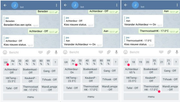

Let me share a "teaser" on what Simon and I have been working on in the last couple of weeks.
Please remember that this is still work in progress as we are also trying to make this as dynamic as possible to fit everybody's needs without too much manual config effort.
Base approach we have taken at this moment for dtgmenu's logic:

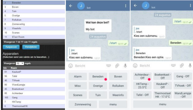

  • Read all Rooms from domoticz and make that the level 1 menu. (image 1)
  • Read all devices/scenes in the room and show them as buttons with their current status (image 2)
  • When you select a device, a 3rd level menu is shown at the top which gives you the pre-defined actions for the device type (image 2 middle/right)
  • Currently supports "Lighting 2" => Switch (On/Off) and Dimmers (On/Off and pre-defines levels) but also ? for a manual option to specify the level.

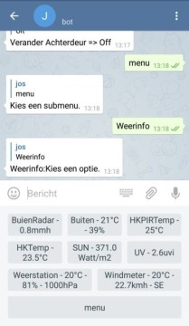

  • Also the option to just show the weather/ temperature info on a menu with buttons.(image 3)
  • Static options: This will allow for any bash/lua commands to start them via the menu with also the option to prompt for a parameter before running that command.
  • It does also have language support so the below Dutch standard replies will be available in any language we define and we plan to use the Domoticz settings as the language to use.
Stay tuned,
Jos
