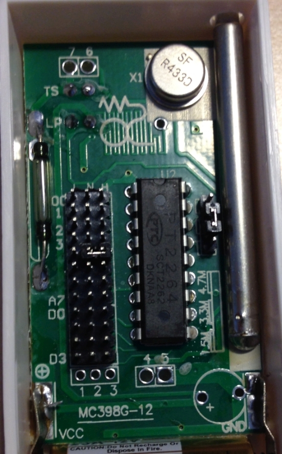

sstolk wrote:@Derik,
The settings for the jumpers as topicstarter mentioned.
I have two of exactly the same one as in this picture.
It's recognized as 'Lighting 4' but somehow I cannot get them to take another ID.
It's always 0000000

Looking closer, I have a different chip: pt2264, brand: FTC

Finally got one to go on another channel: A0 high, A7 low.

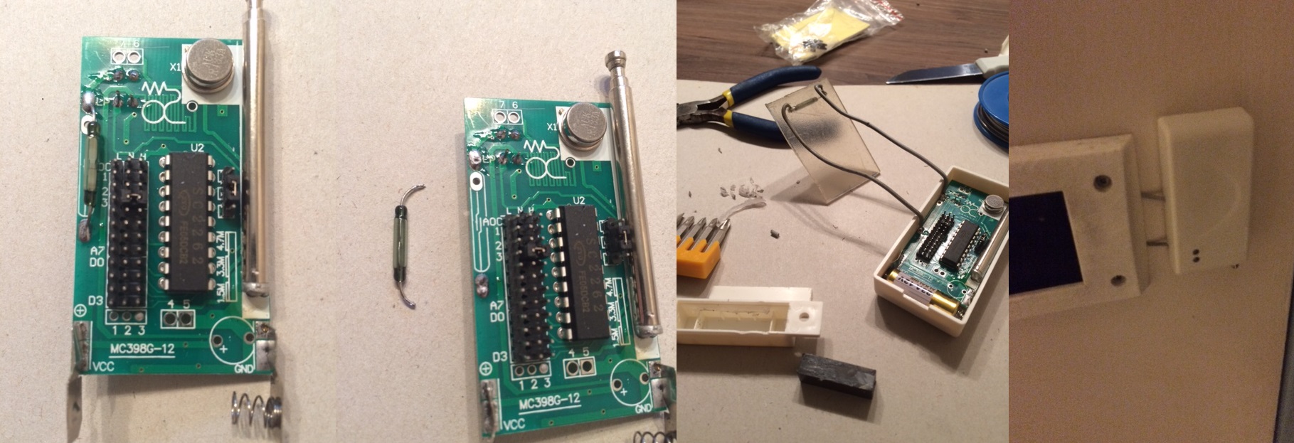

First I want to thank Raspberry Piet for the great idea. Pictures helped me to make my own.
I ordered 3 of those cheap door sensors and all work fine at different ID's.
