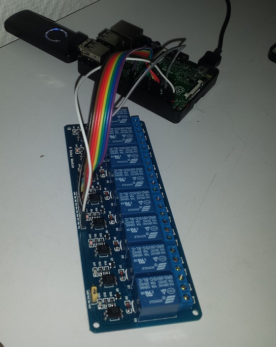

I have one small problem i guess.
RaspBerry 2B + 8 Channel Relays Module
Everything is working, all 8 relays are doing its job, but its working in the wrong direction.
Ofcourse i've made the gpio settings in the scripts (gpio export 17 out, etc) and i've made 2 relays in Domoticz, for testing.
When the raspi is starting up, all relays going to ON with a lot of noise :P and in Domoticz they are OFF while the leds are on.
When i click to OFF they are going to ON, and viceversa..
And, how to setup the relays to stay OFF while booting, now they going all to ON while the state in domoticz is OFF?

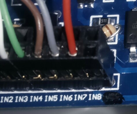

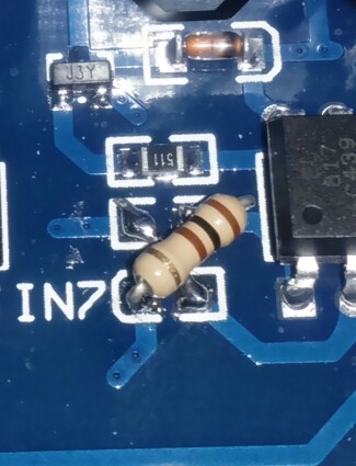

That is the way the relay board works. The relay board is 'active low' (relay active when signal is grounded, while the pi is active high (3,3v = On, 0v = Off).
There is a way to fix that, but you have to desolder the resistors and diodes on the relay board and solder some new resistors and bridges. Do you have a picture of the relay board?

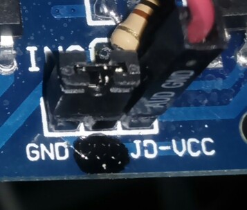

This board isn't designed to be used with the pi. It needs ground to switch the relay on. The pi is grounded when off and 3,3v when on. That is why it acts reversed.
Here is what I did:
I removed the led and the lower resistor. I soldered in a bridge and a 100 Ohm resistor as in the first picture. You have to do this for all 8 relays! I put the jumper between ground and vcc (second picture). 5v from the pi is connected to jd-vcc. The vcc pin on the left pinrow is unused (I cut it away).
