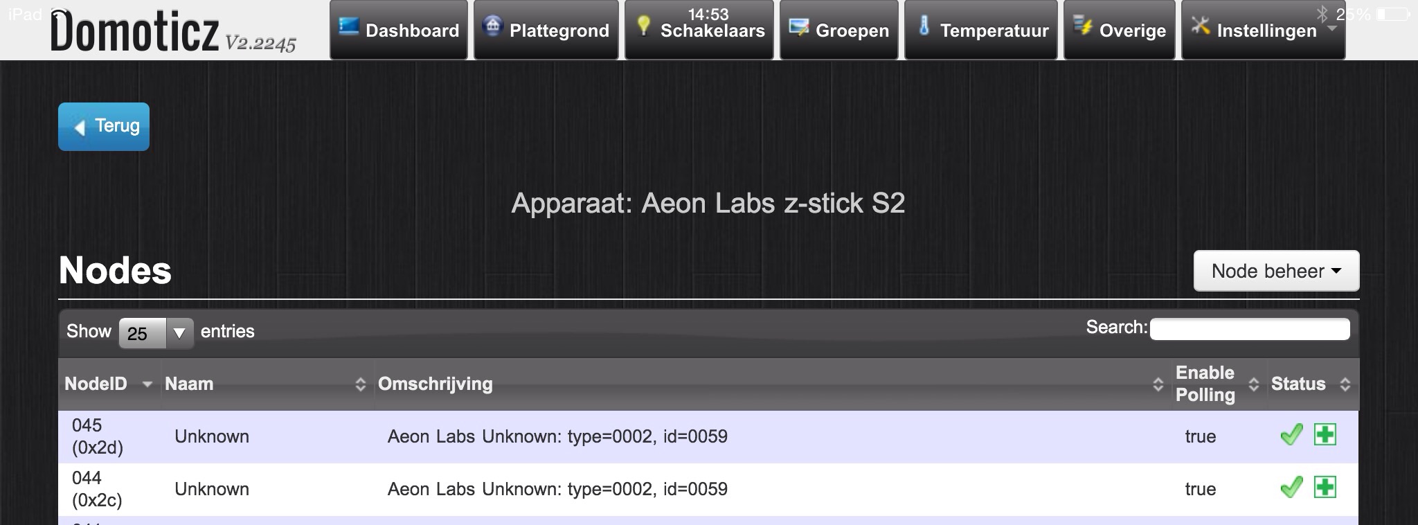

Hi folks,
Last week I recived two of the new aeon labs recessed door sensors aeo-zw089. http://www.pepper-one.de/zwavedb/device/618 but I'm having some troubles to use them..
I'm using a z-stick 2 and inclusion wasn't a problem but sensor doesn't repot its staus to domoticz
It showed up as aeon labs but unknown typed and ID.
someone any idea when sensor will be added to OZW database?
And supported by domoticz?
I have a couple of the old ones (aeon dsb54) and they work great!

- Unknown type
- image.jpg (218.57 KiB) Viewed 9067 times
- Aeo-zw089
- image.jpg (165.63 KiB) Viewed 9067 times

Re: Aeon labs AEO-ZW089 recessed door sensor support.
I set the wake up to 60 just for this testing period
after issuing the following
rm zwcfg_*.xml
rm manufacturer_specific.xml
rm device_classes.xml
wget https://raw.githubusercontent.com/OpenZ ... ecific.xml
wget https://raw.githubusercontent.com/OpenZ ... lasses.xml
then started domoticz as a non sudo user, let it run for a little then stopped it and started the service officially (this is done to get the zwcfg built as a non root user)
I also just poked the pin hole button like 5 times. clicked the sensor a few times and ...!
and it appears that this is now working correctly. I then reset my wakeup back to zero
NOTE: this is on my beta system - and my steps here are a little forceful for a possible production systems, be warned.
rm zwcfg_*.xml
