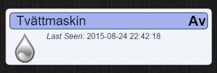

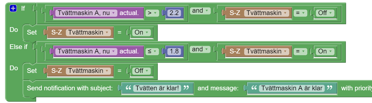

This is my solution using Blockly. Works every time and no dual notifications.
I use a virtual device to see if the machine is running a program or not, great for visible confirmation:
Over 2,2W: washing machine running a program.
1,8W or less: washing machine not running a program or off/stand-by.
You mileage may vary. ;)
ThinkPad
Posts: 890
Re: Pushnotification when dishwasher/washing machine is read
Post by ThinkPad »
My washingmachine uses the same when it is waiting before reversing spinning direction as when it is totally done. So a solution like your Blockly isn't going to work for me :(
