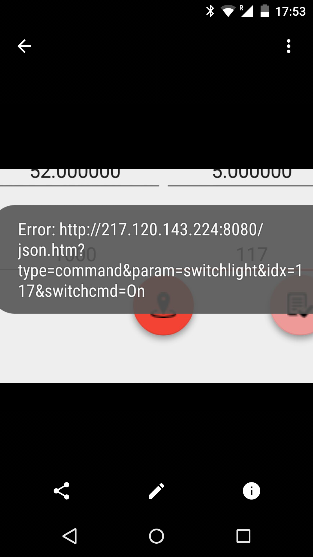

Error
Error
I get an error, and its not the handshake, because I tested it. It looks like the command cannot be executed. Any ideas?

When do you get this error, when crossing the geofence or when you test it?
Possible errors I can think of:
- Temporary network error, so the message can't be send
- Slow network so time-out occurs (time out is set to 3 seconds)
- Username/password error (but then the test shouldn't work, but maybe you accidentally changed it?)

I get it while testing. Immediately after pushing the button. In my opinion it's none of the possibilities mentioned above. I get it at home and beyond the geofence border

Could you try if opening the url in your browser? If you get the 'OK' message there, reinstalling the app might work.

I reinstalled the app. It works. Thx

I got the error too after testing.... forgot to put authentication on "basic-auth" :roll:
