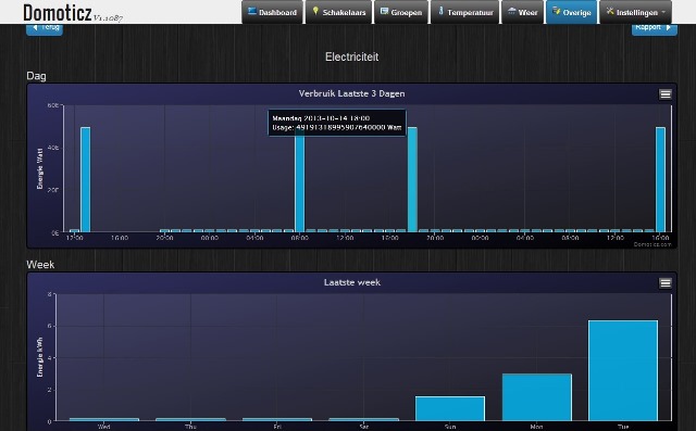

I use RPi + PiFace to count pulses from my power meter. However on every restart of Domoticz (like after an update) the counter will start at 0 again.
This results in an hourly value of 49191318995907640000 Watt. Monthly graphs do no suffer from this. It's only that the other values get so small :-)
I suspect that this because usage is calculated from (current count - last count) which is negative. Does the RFXMeter device store the latest countvalue and/or should the PiFace driver do the same? (or at least get the latest value from the database instead of starting from 0).
Maybe RobinS can comment on this...

I think that you are correct, it seems that the current - last value gets negative when domoticz is restarted and the PiFace driver starts with 0.
Actually I was expecting such behaviour when testing, but then always got sane results... So I was under the impression that Domoticz had a good mechanism to deal with it.
The RFXmeter hardware will most likely store its energy counter in memory, and keep counting.
I will need to fix this, and think that there are 3 solutions to the problem:
1) Have the PiFace driver store the metervalues into a file on disk (do not like this option to much as it could add additional wear to the SD card)
With this method the counter value will be the most acurate because it will store all increments even between the updates to domoticz.
2) Get the last value from the Database as you suggested, and use it.
3) Fix the calculation error of the RFXmeter.
For now this has my preference, as is an RFXmeter is reset (replacement etc), then the same issue will occur.
As well as an RFXmeter overflow from large to 0...

What i do for the 'S0' meter hardware is for the first start retrieve the last value, and use this as an offset,
and/or when the actual value is lower then the last (the meter must have been reset, or the counter is looped), do it again...

As of version 1.1106 the following updates have been made to the PiFace functionality:
- During startup the last counter values are retrieved from the database, and the counters will continue at there last known value.
(eliminating the large glitches that were reported earlier)
- piface.conf is now automatically created when its missing. And will contain default settings for board address 0.
