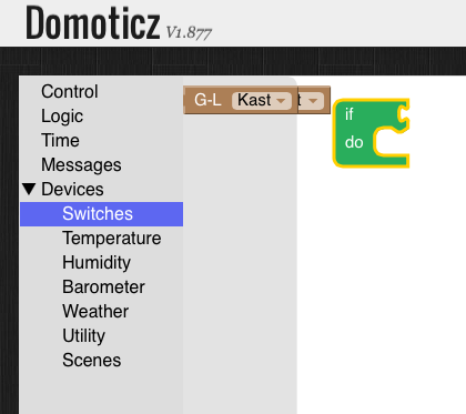

SweetPants
Re: Events system feedback thread
Post by SweetPants »
CopyCatz wrote:Can you be more specific what is going wrong?
As soon as i try to select a switch, there is no drop-down list but the switch icon/menu disappears.

mec
Joined: Friday 12 July 2013 16:58
Post by mec »
Schermafbeelding 2013-07-20 om 10.59.25.png (35.88 KiB) Viewed 8234 times
Same issue over here. Unable to select a switch. (OS X Mavericks / Safari)

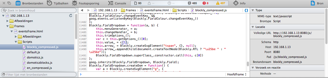

mec
Post by mec »
Schermafbeelding 2013-07-20 om 11.17.37.png (164.44 KiB) Viewed 8222 times
Schermafbeelding 2013-07-20 om 11.17.22.png (130.08 KiB) Viewed 8222 times
This is what is can get from the Safari Errorconsole

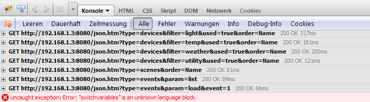

Jochen
Posts: 11
Joined: Saturday 13 July 2013 10:37
Location: Germany / NRW
Post by Jochen »
I got this error when i´m load a saved blockly-event
Firebug
Firebug
