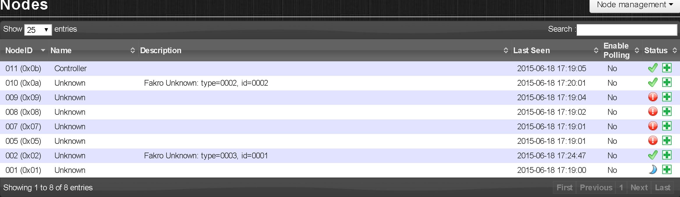

To Include the ZWS230 in the network: disable the Z-wave stick in Domoticz. Take it out and go to your ZWS230.
Push the Z-wave stick button once, it starts blinking. Push the red ZWS230 button for one second. The Z-wave stick will acknowledge by fast blinking. The ZWS230 accepts the network and the red led will be off (see note1)
When you included the ZWS230 in the network, you will see: Unknown: id:0085 Unknown: type=0003, id=0001.
Looking in the manufacturer_specific.xml you will find Fakro and it's id, but you have to add the line in between
Add this: <Product type="0003" id="0001" name="ZWS230"/>
Preferable it would be this:
<Product type="0003" id="0001" name="ZWS230" config="fakro/ZWS230.xml"/>

installation problem in Domoticz
After Inclusion, bring back the Z-stick to Domoticz and enable the Z-stick.
The Z-stick goes in Setup mode and stays in that mode.
There is a recogition and a registration in the zwcfg_xxxxx.xml file But the node starts sleeping ...

At least the ZWS230 is recognized in the Z-wave network:
(note: the ZWS230 is with 5 interconnections a weak contributor to the network, my other nodes do 8 - 13)
The OpenZwavePanel (Node management,Control Panel) shows the current state: SecurityReport
When I looked in the zwcfg_xxxx.xml, I found under Node 18:
There it is about the last part:
query_stage="SecurityReport", while all other nodes are in query_stage="Complete"
The registration of a node is a multi-step query proces, we have a hick-up at QueryStage_SecurityReport: (Table found here: http://www.openzwave.com/dev/classOpenZ ... a644e1f220 )
The Fakro ZWS230 can do secured transmission, but I don't know if Domoticz is ready for that.
Here comes the trick:
Disable the Z-stick.
Edit the zwcfg_xxxx.xml.
Replace query_stage="SecurityReport" by query_stage="ManufacturerSpecific2"
Enable the Z-stick.
The QueryStage_SecurityReport is skipped and ...
Tada ... the Fakro ZWS230 is available under Devices where you can name it and add it to the Switch tab

ErikJ
- Posts: 16
- Joined: Saturday 13 June 2015 9:01
Re: Z-Wave Window opener Fakro ZWS230
Hello Domosapiens,
Recently I bought a Fakro window with electric opener and the outdoor shutter which is also electric. If I read you post correctly you explain that you can determine the opening position as follow. Event open (window open), closing action (window stops) again closing action (window closes). In my case, I can only open the window completely and if I use the close action the windows stops for a second and then it will close completely.
Do you have anything changed so you got the action of stopping?
I use Domoticz on a Synology NAS combined with Aeon USB stick. At my window there is AB enclosed which was already linked with the window and shutter. As a result I could not connect the USB stick directly to the Fakro and have to do some things to include the Aeon in the same network (I got it done with an external tool on the PC).

ErikJ
- Posts: 16
Hello Domosapiens,
Thanks for your quick reply
I already tried the option with the venetian blinds, but when I use the stop command there will be an error popup “Error sending switch command, check device/hardware” and no stop action.
So I tried your other suggestion and exclude the stick and the fakro. After that I include the fakro directly to the aeon stick. Bit still the same action. Open is open all the way en close is close all the way. There is no combination witch I can use to stop de Fakro during the open or close action.
Maybe I have a newer model and the stop action is an extra command. If I use a different Zwave software there is definition: Switch multilevel. But if I send the command with that software is the same result.
In Domoticz I have two extra zwave devices, but when I tried to activated the command I receive the notification: Error sending switch command, check device/hardware.
At the hardware tab is see the information as enclosed, so if I am right the sticks sees some more devices. But no extra details.
At this moment I only have the Fakro window opener and Fakro outdoor shutter. So is it possible that the stick receives extra information/commands but domotics cannot handle/translate them?
A other thing is that a cannot find the file zwcfg_xxxx.xml, only zwcgf.xsd and in that file and all the others there is no such details as you describe earlier in this topic.
Hope you have some more suggestions, otherwise I am at a dead end.

- Domosapiens
- Posts: 232
- Joined: Wednesday 20 August 2014 12:08
- Target OS: Windows
- Domoticz version: V3.5981
ErikJ.
You are running on NAS but I assume it's the same.
Without the zwcfg_xxxx.xml file I think no Z-wave device will work in Domotics
You Z-stick has a zwcfg_xxxx.xml file (with xxxx as your specific stick number).
There you can find the lines of your Fakro, and check if it's in the query_stage="Complete"
Find att. from my zwcfg the part of 1 of the Fakro ZWS230.
Then I have 1 device, that can be configured in the switch tab. Hope this helps
Domosapiens
Domosapiens

Domosapiens wrote: Monday 27 April 2015 9:42 ...
When I looked in the zwcfg_xxxx.xml, I found under Node 18:There it is about the last part:Code: Select all
<Node id="18" name="Unknown" location="" basic="4" generic="17" specific="6" type="Motor Control Class B" listening="true" frequentListening="false" beaming="true" routing="true" max_baud_rate="40000" version="4" query_stage="SecurityReport">
Enable the Z-stick.
Tada ... the Fakro ZWS230 is available under Devices where you can name it and add it to the Switch tab![]()
Tnx for the information regarding the multi stage pairing process. I'm not going to hijack the post. But I hope it will help me figure out why I've some missing sensor information.
