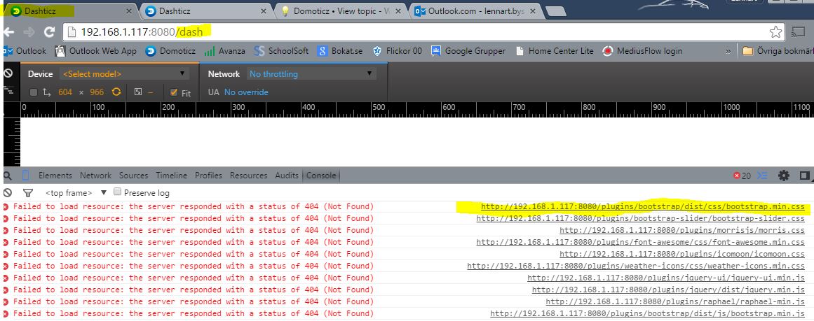

I get
Failed to load resource: the server responded with a status of 404 (Not Found)
http://192.168.1.117:8080/plugins/bootstrap-slider/bootstrap-slider.css Failed to load resource: the server responded with a status of 404 (Not Found)
http://192.168.1.117:8080/plugins/morrisjs/morris.css Failed to load resource: the server responded with a status of 404 (Not Found)
http://192.168.1.117:8080/plugins/font-awesome/css/font-awesome.min.css Failed to load resource: the server responded with a status of 404 (Not Found)
http://192.168.1.117:8080/plugins/icomoon/icomoon.css Failed to load resource: the server responded with a status of 404 (Not Found)
http://192.168.1.117:8080/plugins/weather-icons/css/weather-icons.min.css Failed to load resource: the server responded with a status of 404 (Not Found)
http://192.168.1.117:8080/plugins/jquery/dist/jquery.min.js Failed to load resource: the server responded with a status of 404 (Not Found)
http://192.168.1.117:8080/plugins/bootstrap/dist/js/bootstrap.min.js Failed to load resource: the server responded with a status of 404 (Not Found)
http://192.168.1.117:8080/plugins/jquery-ui/jquery-ui.min.js Failed to load resource: the server responded with a status of 404 (Not Found)
http://192.168.1.117:8080/plugins/raphael/raphael-min.js Failed to load resource: the server responded with a status of 404 (Not Found)
http://192.168.1.117:8080/plugins/morrisjs/morris.min.js Failed to load resource: the server responded with a status of 404 (Not Found)
http://192.168.1.117:8080/plugins/bootstrap-slider/bootstrap-slider.js Failed to load resource: the server responded with a status of 404 (Not Found)
http://192.168.1.117:8080/plugins/skycons/skycons.js Failed to load resource: the server responded with a status of 404 (Not Found)
http://192.168.1.117:8080/js/dashticz.js Failed to load resource: the server responded with a status of 404 (Not Found)
http://192.168.1.117:8080/plugins/bootstrap/dist/css/bootstrap.min.css Failed to load resource: the server responded with a status of 404 (Not Found)

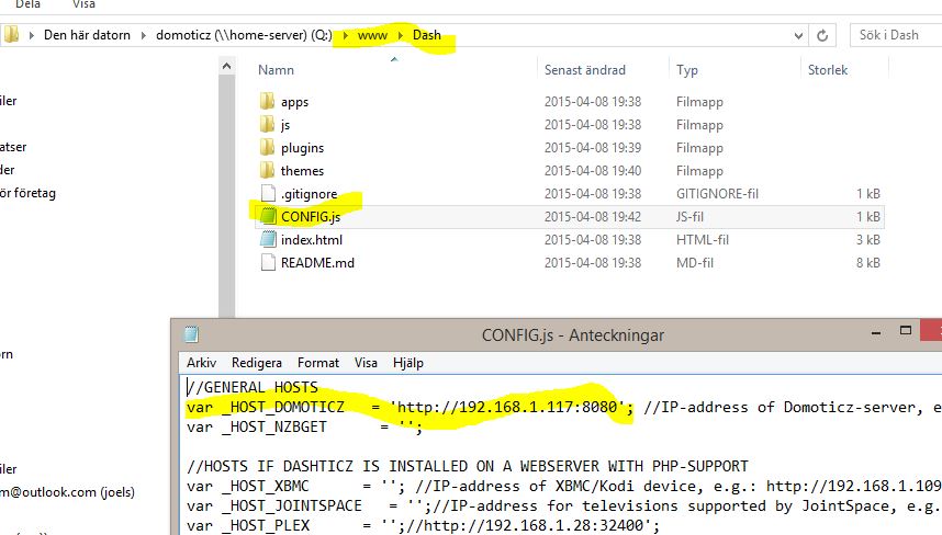

here is the folders and CONFIG.js file:
and here is the browser
If I look in the directories I can find the files as its reporting as errors... Not sure what to do now.. Bumer
