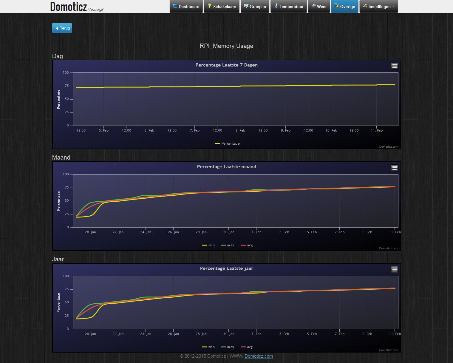

Just curious how the processor behaves, I looked in Domoticz at RPI_MemoryUsage: see the attached file
The diagram shows a slow dayly increase in usage.
Not much per day, therefore plenty of space left, but at a certain future time it will hit the limit.
Remedy is simple: shutdown & reboot. But that is an on-purpose interruption to continuous operation.
;-) For lazy users of Domoticz@RPI: is there a way, either to automatically stop that increase, or to periodically reset to a low value of memory usage?

This has been discussed before on the forum and is almost certain it are internal cache file of the systems that gets deleted when more memory is needed

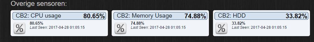

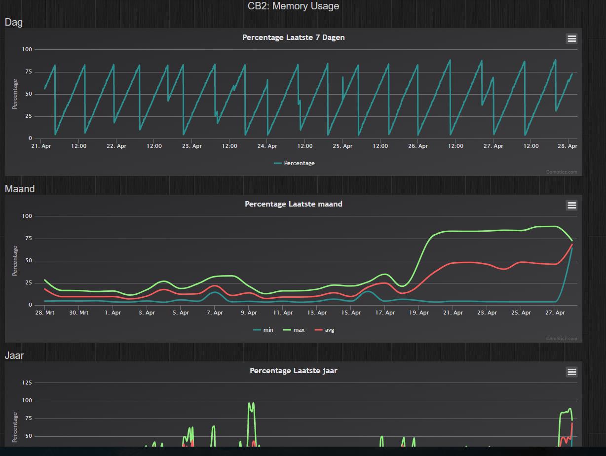

My CB is running not fine..
many times a reboot, without a reason for me ... :oops: :oops:
Is this perhaps the problem:
This strange or not?
Looks from the 19 april there is high use of memory..
Is there a option to reset this?

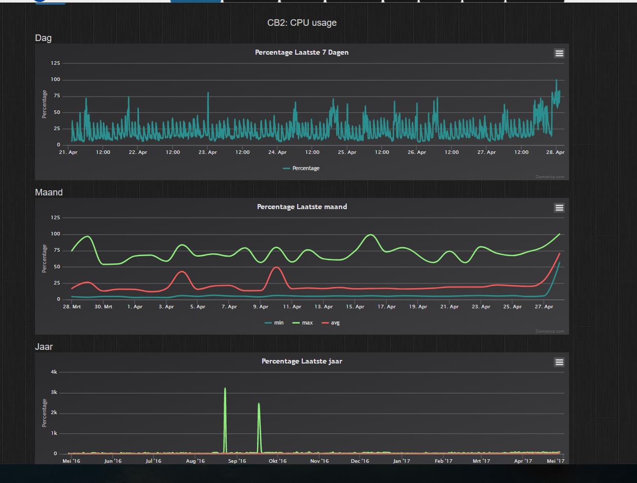

And my Cpu:

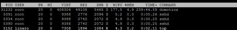

Domoticz.... Eating my CPU:
Can i look in in domoticz what the cpu uage is?
Strange that root is the owner..
Linaro should be the Domoticz user?
Or is root a user of Domoticz to?
