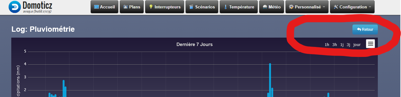

Hello, since the last update, the button for viewing a rainfall report, which used to be located in the top right corner of the rain sensor log screen, has disappeared.
Will it be possible to restore it in the next version?
Thank you.

Re: The rainfall report has disappeared
Sorry about that. The rain log has been converted to the angular style as others.
https://github.com/domoticz/domoticz/co ... 33b3a8d13f
Already pushed the patch to solve this, and will be available later this morning in a new beta
The report button is there but no response when clicking on the report button or an empty screen.
Tried this on a mobile device with Firefox browser in private mode.
Also on other devices the report function is not working.
It is there. Thank you.
