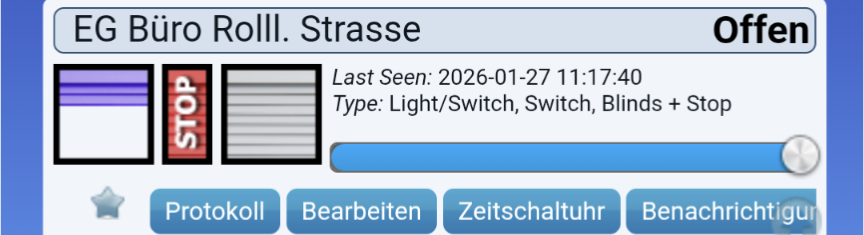

I have replaced my roller shutter relaus from a broken Shelly 2.5 against a Shelly 2PM. I could manage to include the new 2PM to Domoticz via "Shelly Teacher" and "MQTT Client Gateway with LAN interface". The old broken 2.5 was inlcluded via "Shelly MQTT" Hardware.
Beforehand, there was a switch "Blinds Percentage" where I could slide to the wanted opening value. Now there is a switch "Blinds + Stop". It works, but if the slider is moved, it only accepts Zero or 100%. Every other level is ignored. But the slider of the Shelly Web interface works perfectly.
Any hint is welcome.

Re: Slider of Roller shutter "Blind+Stop" not working
I think Shelly teacher needs the "MQTT AD" gateway, not the normal MQTT interface.
And besides that the shelly teacher has been out of maintenance so a fix will mean you have to create your own MQTT AD config payload for this device (no idea what it should be)

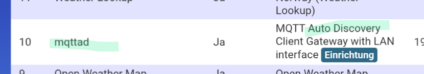

Oh, sorry. In fact I do use MQTT AD.
Yes, I really have to spend some time in getting new generation Shelly devices properly into Domoticz. The old easy automatic methods are outdated ... sigh.
