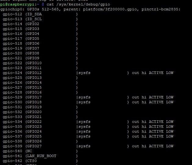

I think you will find the new GPIO numbers in the file /sys/kernel/debug/gpio. Also i think you can find the new gpio numbers by adding 512 to your old gpio number, gpio 6 will be gpio 518
- Domoticz_Bookworm_GPIO.jpg (75.23 KiB) Viewed 48 times

cat /sys/kernel/debug/gpio | grep GPIO6 => gpio-575 (GPIO6
cat /sys/kernel/debug/gpio | grep GPIO21 => gpio-590 (GPIO21
cat /sys/kernel/debug/gpio | grep GPIO26 => gpio-595 (GPIO26
So seems that : NewGIPO=OldGPIO+569
