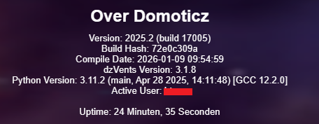

since we yesterday updated our server with domoticz (and all other containers) a lot of our plugins are not working anymore.
After some lookaround it has to do with the new python version.
It always was 3.11 and that worked perfectly for years, but after updating to the last version of domoticz, the Python is 3.15.
That seems the issue.
Traceback (most recent call last): File "<string>", line 1, in <module> import telnetlib ModuleNotFoundError: No module named 'telnetlib' FATAL: telnetlib not available
Also some libs are not working anymore as wel, like the midea aircon plugin.
Please fix this.
For no we reverted back to 2025-beta.17005, that seems to be the last working version.

Last update:
Last night we went back to our domoticz test container and let it work for a night.
It seems that z2m is working again, so no issues for that anymore.
( i recreated the z2m and domoticz container after the domoticz update, and that seems to work)
The heospy script is working correctly with the (pip install telnetlib-313-and-up) telnetlib, so thats fine also.
I'm going to invest more time soon to check other logs/errors about missing libraries or dependencies of plugins that not work at this moment.
If i know more, i come back soon!
