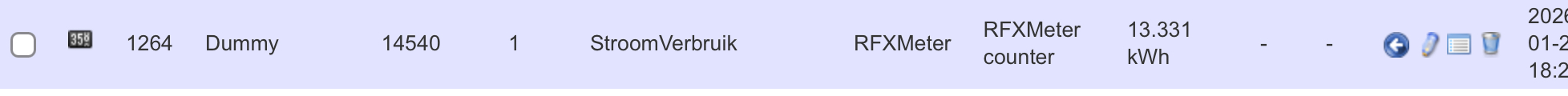

What type of sensor do you use on your Pi4?

This one on pi4 with old domoticz:
- IMG_6755.jpeg (71.17 KiB) Viewed 164 times

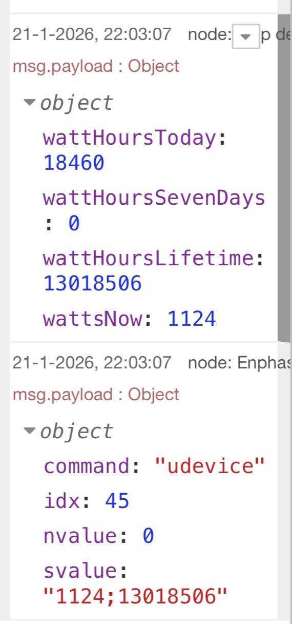

edwin1234
- Posts: 330
- Joined: Sunday 09 October 2016 20:20
- Domoticz version: 2021.1
- Location: Nederland
Re: Enphase verbruik
Now i have this:
But still no value in domoticz
- IMG_6756.jpeg (281.21 KiB) Viewed 150 times
- FireWizard
- Posts: 1967
- Location: Voorthuizen (NL)
Hi @edwin1234,
Something else is wrong.
I do not understand, that you produce 1124W at 22:03:07 on January 21st. Or is it the Northern Light
Correct this first.
Correct this first.
- Posts: 6676
- Domoticz version: 2025.1
Ah OK, You are using a normal counter (RFX Counter) on the old Pi4. That indeed only needs 1 value (WattHoursLifetime).
