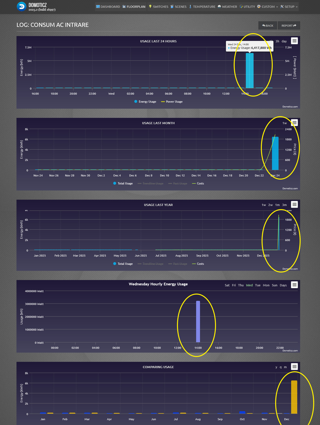

I encountered a problem. When I disconnected a smart plug for a few seconds and then reconnected it, Domoticz recorded the total amount of energy accumulated over the years for an hour. I encountered this on 2 devices several times. How can I delete those values?
Domoticz 2025.2 (build 16997) on raspberry pi 4
Thank you!
Energy recorded problem

Re: Energy recorded problem
The next day you can remove that incorrect value by doing a shift+click on it in the month graph. You will get a popup to remove the value. It will stay visible in the day graph but disappear when that day has been purged.

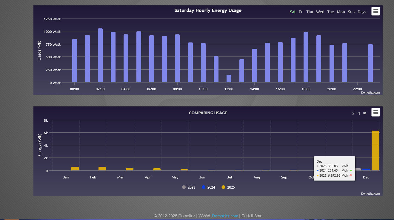

hI, i deleted the wrong values...but in comparing usage graph he keeps it.
Then you have to thinker in the database yourself to find the issue (on your own risk). Install "DB Browser for SQLite": https://sqlitebrowser.org and look into a database backup to check and try out.
Then stop Domoticz, modify the database and start Domoticz again.
