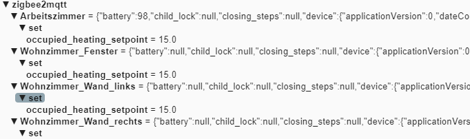

I have no config topic for the devices in my zigbee2mqtt broker. Do I have to activate something specific to publish the config topic?
- Screenshot 2025-11-21 001252.png (27.91 KiB) Viewed 187 times

The discovery topic is always broadcasted a startup of ZIGBEE2MQTT and isn't under "/zigbee2mqtt"!
Default topic is /homeassist unless you have changed it to something else. Just check either your ZIGBEE2MQTT config, or the MQTT AD HArdware in Domoticz for the appropriate topic.

The device was created in the past and the errors appeared after updating to 2025.2 stable. I haven´t tried to recreate the device yet.
