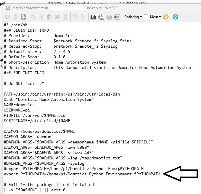

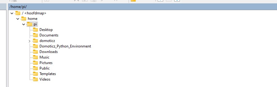

I did follow option 1. What i did was:
mkdir Domoticz_Python_Environment
cd /home/pi/domoticz/plugins/Domoticz-Zigbee
python3 -m pip install -r requirements.txt --upgrade -t /home/pi/Domoticz_Python_Environment
After that i edited the file domoticz.sh in the folder /etc/init.d and added:
export PYTHONPATH=/home/pi/Domoticz_Python_Environment:$PYTHONPATH
After this you can do the next steps of the plugin installation

Hi Rik60,
I tried this initially, but I ran into the problem that the folder is read-only. And no matter what I try to get write access to it, it doesn't work. Before Debian Bookworm, I could edit any Linux folder in Windows Explorer without any problems, but that's no longer possible. Bookworm and Trixie are no longer recognized by Windows.
Yours sincerely,
Fred
Rasberry Pi 3B+ - Debian Trixie - Domoticz 2025.2
RFLink - RFXCom - Zigbee (CC2531)
P1 Smart Meter - KaKu
Fredom
Posts: 160
Joined: Saturday 19 September 2020 21:02
Domoticz version: 2025.1
Location: Krimpen aan den IJssel
Re: Z4D install problem
Post by Fredom »
It worked!!
I finally managed to change the read-only permissions with sudo chmod 777.
All steps went smoothly.
