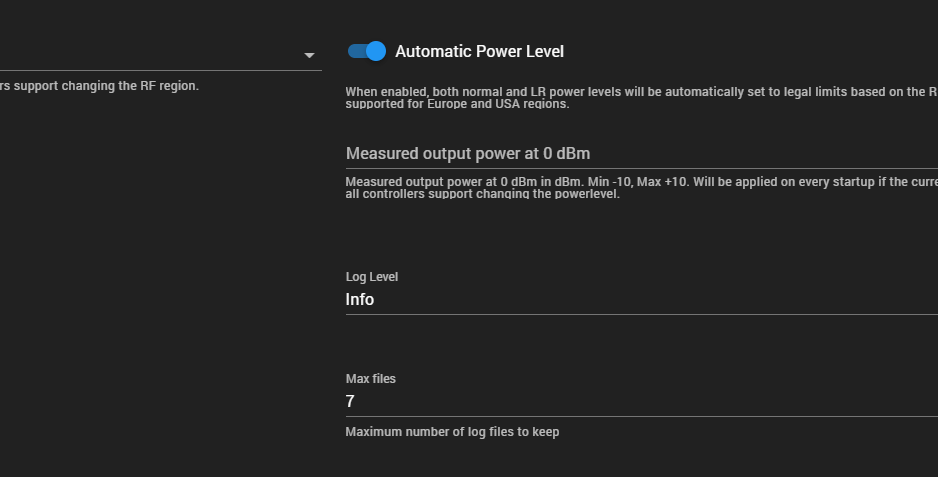

Is there a way to disable this log entries ??
I've set the log level in the Z-wave-JS UI to Info
2025-11-02 15_56_40-toon – _VM Domoticz 1 – WinSCP.png (24.06 KiB) Viewed 36 times

The log settings from Domoticz is separate from ZWaveJS-UI
You can click on the MQTT AD hardware in domoticz and change the log settings here
You also did not install MQTT Auto Discover, but you installed ZWaveJS-UI.

ah. That simple
Thanks for the swift reply
