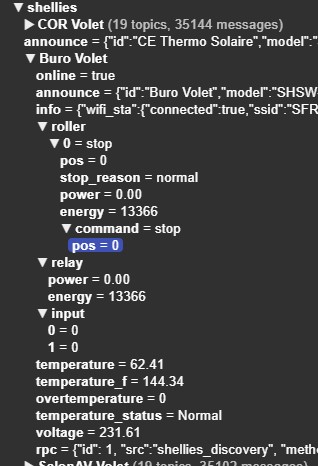

"Volet_Volet": {
"topic": "shellies/buro_volet/roller/0",
"type": "244",
"subtype": "73",
"switchtype": "21",
"mapping": {
"state": { "topic": "shellies/buro_volet/roller/0", "value_template": "{{ value_json.roller.pos }}" },
"position": { "topic": "shellies/buro_volet/roller/0/pos", "value_template": "{{ value_json.roller.pos }}" },
"power": { "topic": "shellies/buro_volet/roller/0/power","value_template": "{{ value_json.power }}" },
"energy": { "topic": "shellies/buro_volet/roller/0/energy","value_template": "{{ value_json.energy }}" }
"commands": {
"Open": {"topic": "shellies/buro_volet/roller/0/command", "payload": "open"},
"Close": {"topic": "shellies/buro_volet/roller/0/command", "payload": "close"},
"Stop": {"topic": "shellies/buro_volet/roller/0/command", "payload": "stop"},
"Set Level":{"topic": "shellies/buro_volet/roller/0/command/pos", "payload": "<level>", "retain": true},"direction": "both"}

I should have a problem, as I wrote a message twice this morning, and none of them have been published, while I saw them... I hope this one will stay...
I updated readme with some advice on how to find right topic and values. You can find it at https://github.com/FlyingDomotic/domoti ... ttexplorer
In your case, definition file should be something like:
	"Buro Volet": {
		"topic": "shellies/Buro Volet/roller/0",
		"type": "244", "subtype": "73", "switchtype": "21",
		"mapping": {"item": ""},
		"commands": {
			"Open": {"command": "http://192.168.1.75/roller/0?go=open"},
			"Stop": {"command": "http://192.168.1.75/roller/0?go=stop"},
			"Close": {"command": "http://192.168.1.75/roller/0?go=close"}
FYI, syntax you're using in your previous message is a mix between MqttMapper and HomeAssistant. You won't get an error, as JSON is valid, but noway to get something working ;-) However, command syntax may work, if Shellies are reading these topics.

Always a problem of mapping (commands it's ok).
Device Shelly MQTT Name : buro
Device Domoticz created by SHellyMpper : ShellyMapper - buro
Device : Shelly 2.5 Gen 1
Mapping : "mapping": {"item": ""}, > not functionnal in Domoticz, no back state Device but update time is OK
So, I use Mapping with state and position (chatGPT)
Log domoticz error :
2025-10-23 21:37:11.526 ShellyMapper: Pushing 'ReadEvent' on to queue
2025-10-23 21:37:11.553 ShellyMapper: Processing 'ReadEvent' message
2025-10-23 21:37:11.553 ShellyMapper: Received 30 bytes of data
2025-10-23 21:37:11.553 ShellyMapper: 30 1c 00 16 73 68 65 6c 6c 69 65 73 2f 62 75 72 6f 2f 72 6f 0...shellies/buro/ro
2025-10-23 21:37:11.553 ShellyMapper: 6c 6c 65 72 2f 30 73 74 6f 70 .. .. .. .. .. .. .. .. .. .. ller/0stop
2025-10-23 21:37:11.554 ShellyMapper: Pushing 'onMessageCallback' on to queue
2025-10-23 21:37:11.554 ShellyMapper: Processing 'onMessageCallback' message
2025-10-23 21:37:11.554 ShellyMapper: Calling message handler 'onMessage' on 'module' type object.
2025-10-23 21:37:11.554 ShellyMapper: onMQTTPublish found shellies/buro/roller/0, Device 'ShellyMapper - buro', message 'stop'
2025-10-23 21:37:11.554 Error: ShellyMapper: No mapping for ShellyMapper - buro
JSON :
"ShellyMapper - buro": {
"type": "244",
"subtype": "73",
"switchtype": "21",
"topic": "shellies/buro/roller/0",
"mapping": {
"state": {
"value": {
"open": 100,
"close": 0,
"stop": 50
"position": {
"topic": "shellies/buro/roller/0/pos",
"value_template": "{value}"
"commands": {
"Open": {
"topic": "shellies/buro/roller/0/command",
"payload": "open"
"Close": {
"payload": "close"
"Stop": {
"payload": "stop"
"Set Level": {
"topic": "shellies/buro/roller/0/command/pos",
"retain": false }
Have you an idea ?

Posts: 463
Re: Python Plugin: MqttMapper
Post by FlyingDomotic »
I have an idea: don't trust what ChatGPT may tell you!
It's merging syntax of different systems (MqttMapper and Home Assistant), making configuration file illegal for MqttMapper. This won't crash MqttMapper, but just nothing will work, as you can see...
If you want to check a MqttMapper configuration file, just go to MqttMapper folder and run checkJsonFile
cd
cd domoticz/plugins/MqttMapper/
./checkJsonFiles.py
You probably will see something like:
   Error: item is mandatory in >ShellyMapper - buro:mapping<
   Error: state is unknown in >ShellyMapper - buro:mapping<
   Error: position is unknown in >ShellyMapper - buro:mapping<
You may have a look to documentation at https://github.com/FlyingDomotic/domoti ... r-pluginto see legal syntax.
Now, if proposed configuration file don't work, let's try with this one:
	"Buro Volet": {
		"topic": "shellies/Buro Volet/roller/0/command/pos",
		"commands": {

Hello
Thanks for your help
Command and Update DZ device work for my shelly 2.5 Gen1 (mode roller) ;)
JSON :
For Update : Topic is : /roller/0/pos
For Command : Topic is /roller/0/command
"type": "244",
"subtype": "73",
"switchtype": "21",
"commands": {
"Open": { "topic": "shellies/buro/roller/0/command", "payload": "open" },
"Close": { "topic": "shellies/buro/roller/0/command", "payload": "close" },
"Stop": { "topic": "shellies/buro/roller/0/command", "payload": "stop" },
"Set Level": { "topic": "shellies/buro/roller/0/command/pos", "payload": "<level>", "retain": false }

oli80330
Posts: 8
Joined: Saturday 11 January 2014 15:21
Domoticz version: 2025.2
Location: FR, Amiens
Post by oli80330 »
Json for sdhelly 2.5 roller works fine.
several JSON examples for shelly (1/2.5/EM Gen1) :
1 - For a Shelly 1 (GEN1) / domoticz device on/off :
"SDB Ventil": {
"topic": "shellies/SDB Ventil/relay/0",
"switchtype": "0",
"mapping": {"item": "", "default": "0", "values": { "off": "0", "on": "100", "false": "0", "true": "100" }},
"commands": {
"On": {"topic": "shellies/SDB Ventil/relay/0/command", "payload": "on"},
"Off": {"topic": "shellies/SDB Ventil/relay/0/command", "payload": "off"}
2- For a Shelly 2.5 mode relay (not roller mode) (GEN1) / domoticz on/off :
"CE Mode PAC": {
"topic": "shellies/CE Thermo Solaire/relay/0",
"switchtype": "0",
"commands": {
"On": {"topic": "shellies/CE Thermo Solaire/relay/0", "payload": "on"},
"Off": {"topic": "shellies/CE Thermo Solaire/relay/0", "payload": "off"}
3 -For a Shelly 2.5 mode roller (not relay mode) (GEN1) / domoticz blinds on/off/stop/position :
"ShellyMapper - Buro Volet": {
"topic": "shellies/Buro Volet/roller/0/pos",
"type": "244",
"subtype": "73",
"switchtype": "21",
"commands": {
"Open": { "topic": "shellies/Buro Volet/roller/0/command", "payload": "open" },
"Close": { "topic": "shellies/Buro Volet/roller/0/command", "payload": "close" },
"Stop": { "topic": "shellies/Buro Volet/roller/0/command", "payload": "stop" },
"Set Level": { "topic": "shellies/Buro Volet/roller/0/command/pos", "payload": "<level>", "retain": false }
4 - For a Shelly EM or Shelly 2.5 (Gen1 conso) / domoticz General, kWh :
"Clim Salon": {
"topic": "shellies/Clim Salon/relay/0/power",
"type": "243", "subtype": "29", "switchtype": "0",
"options": {"EnergyMeterMode":"0"},
"mapping": {"item":"~*;~0"}
Thank you very much for your plugin, very fast for feedback in MQTT !
The CPU consumption of the RPi is very low.
A good plugin for shelly device, better than shellyteacher or AutoDiscovery, very slow in feedback.
Domoticz depuis 2015, pilotage : volets, lumières, températures, energie, solaire... RFXCOM/ZigBee/Shelly/ESP
