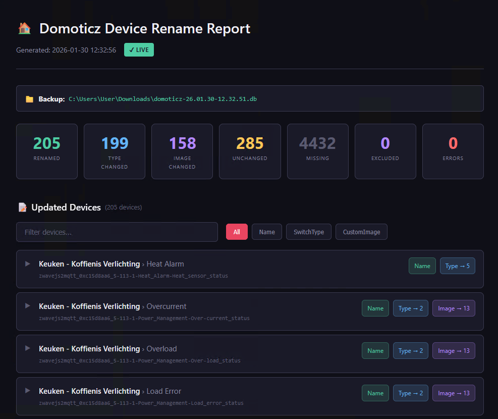

  • Generates an interactive HTML report with search/filter to review all changes.

5. Check the generated HTML report to see what will be renamed.
