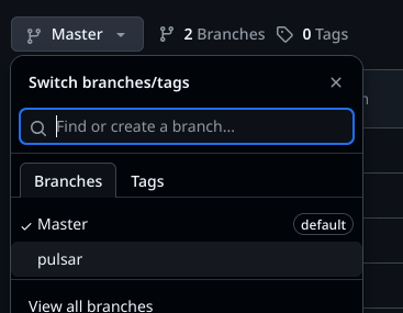

Okay, I have another version of the plugin that uses Pulsar a different type of communication.

ronalddevos wrote: Where do I find the other plugin? Tried 'git pull' but 'already up to date'
For the readme... change to pulsar.
Schermafdruk van 2025-09-26 19-22-31.png (22.69 KiB) Viewed 102 times
In the plugin folder
git checkout pulsar
Restart Domoticz
To revert
git checkout Master
ronalddevos wrote: Oh, and thanks for your help, btw!
