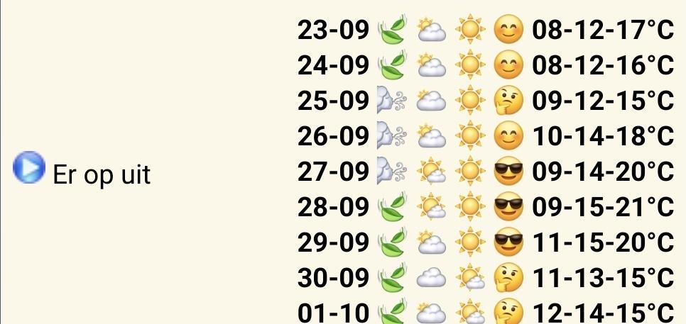

I like biking, but I am a nice weather biker.
Due to time constraints I must plan in advance.
So I suggested DeepSeek to write me a script with a 10 day forecast.
To prepare:
- get yourself a key for the API at meteoserver.nl
- Make a dummy device type TEXT and name it 'Er op uit'
- change the script according to where you live (my_home_town) and replace the abcdef1234 with you API key
That's all.

Display format for each day:
DD-MM 🌫️ ☀️ 🌦️ 😊 10-15-20°C
Where:
- DD-MM: Date (day-month)
- 🌫️: Wind indicator (🌫️=calm, 🍃=light, 🌬️=moderate, 💨=strong, 🌪️=stormy)
- ☀️: Cloud cover (☀️=sunny, 🌤️=mostly sunny, ⛅=partly cloudy, 🌥️=cloudy, ☁️=overcast)
- 🌦️: Precipitation (☀️=dry, 🌤️=light clouds, ⛅=cloudy, 🌦️=light rain, 🌧️=rain, ⛈️=heavy rain/thunder)
- 😊: Temperature feeling (🥶=freezing, 😰=cold, 🤔=chilly, 😊=pleasant, 😎=perfect, 🔥=warm, 🥵=hot)
- 10-15-20°C: Min-Avg-Max temperatures
