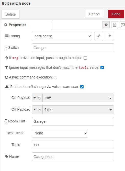

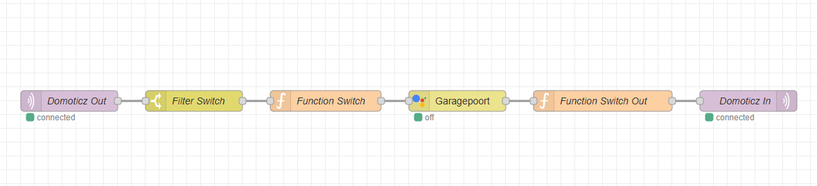

I'm struggeling with my node red workflow setup in order to open/close my garagedoor via Smart-Nora - google assistant. I used to use Homebridge but as the service became paid I started looking for a free alternative.
I'm able to connect to Domoticz and to Smart Nora but not able to send/receive commands from/to Domoticz. I have no experience with the different functions available or how to compose the messages.

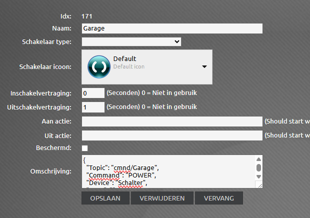

My set-up:
Domoticz garage door via sonoff switch (IDX 171) push button (on/off) with 1 sec delay to auto return to initial On state & with extra sensor (IDX 172) to verify if the door is open or not.

So I'm not sure if the flow is correct and if so, if someone can help me out with the correct functions. Activation (Power) is the only action I need I suppose as the switch will automatically return to the off state 1sec later.
My flow in Node-red:
