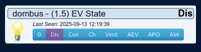

Hi @waltervi. Thanks very much for your reply and sorry for my super late reply (only now had a moment of peace).
I might be overcomplicating things, so perhaps I'll explain what I'm trying to achieve in full. I want that when this device
Screenshot from 2025-09-13 12-19-41.png (12.32 KiB) Viewed 148 times
switches from disconnected (dis) to connected (con) state the input variable "Update interval (seconds):" in the below shown hardware
is updated from 30 seconds or 11 seconds, or vice-versa when it switches from con to dis. Is there a simpler way to do this? :?

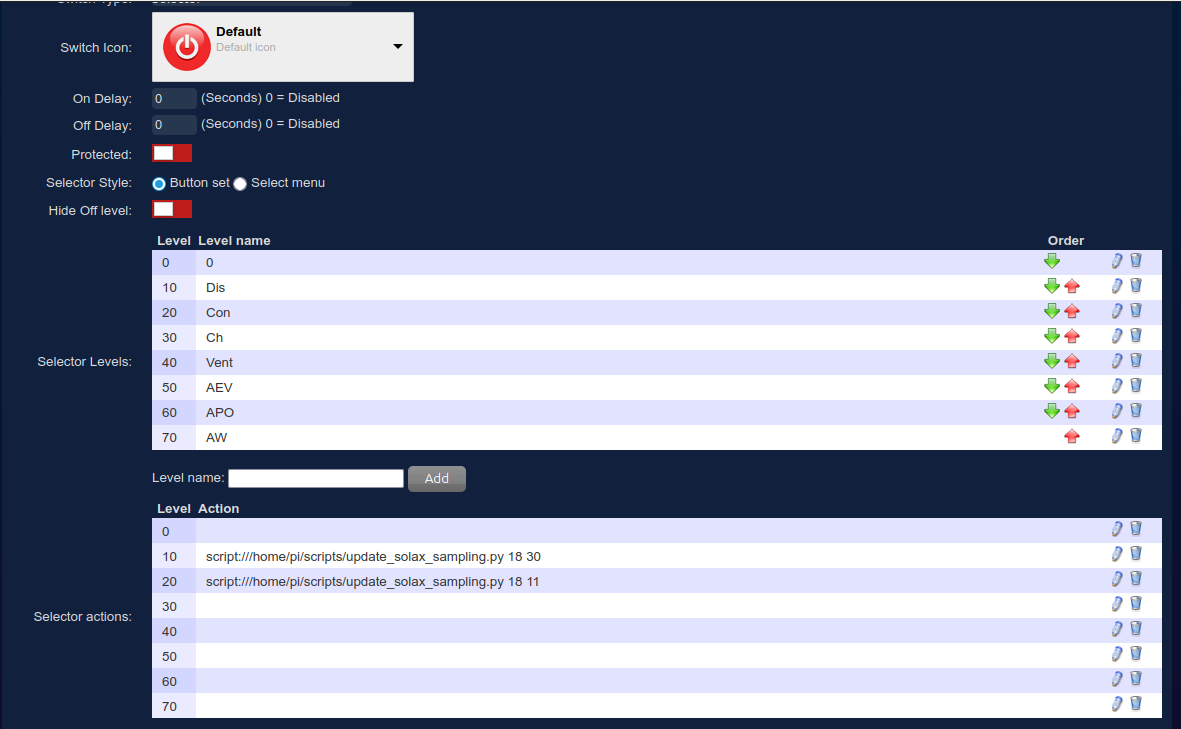

and this is how the device looks like
Screenshot from 2025-09-17 18-51-53.png (79.83 KiB) Viewed 108 times
