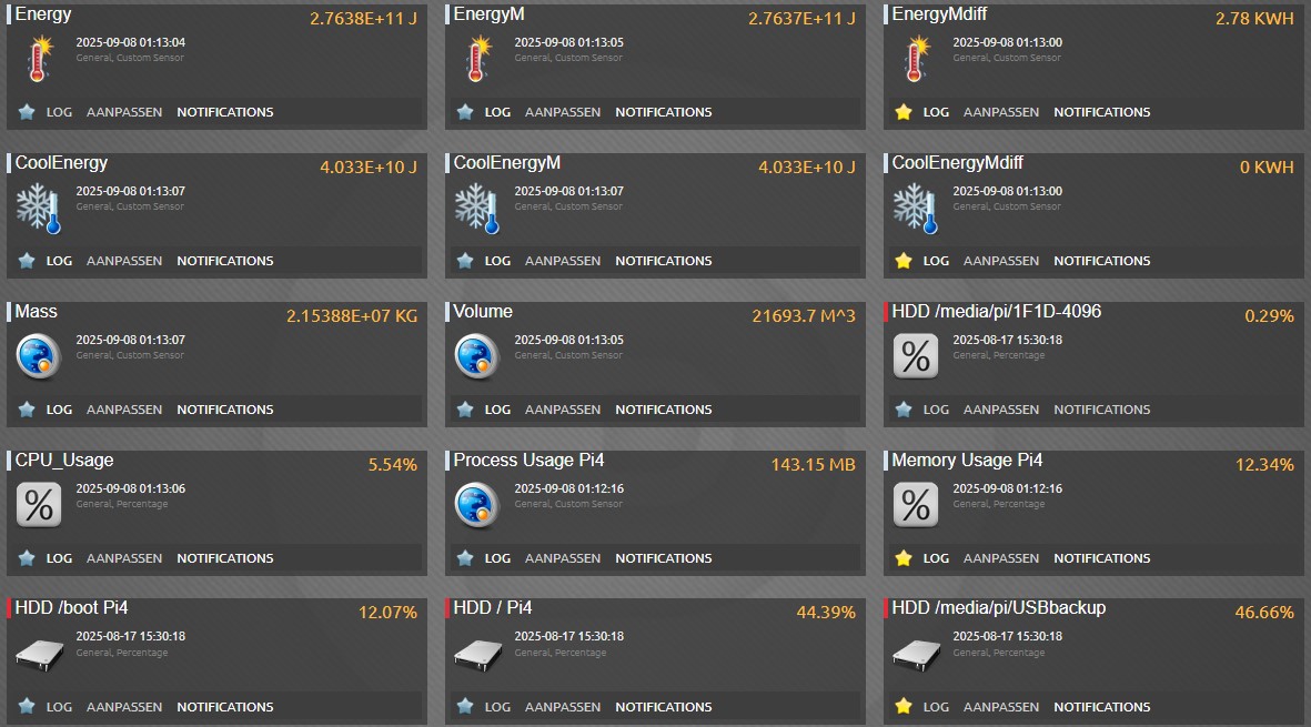

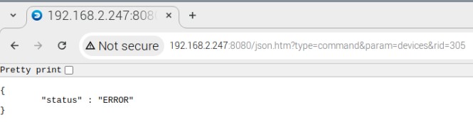

Only thing left is the result of dCOP calculation from a php script is no longer updated in Domoticz. Also checked that script on the “command&param” part. But that looks okay.

Unfortunately, I'm getting an error. The script hasn't been changed since Domoticz version 2024.7. So I don't understand why it suddenly stopped working after updating to 2025.1.
By the way, a number of motherboard devices also stopped updating after the update
Schermafbeelding 2025-09-08 011412.jpg (172.1 KiB) Viewed 88 times
Schermafbeelding 2025-09-07 235724.jpg (18.27 KiB) Viewed 88 times
Posts: 6677
Domoticz version: 2025.1
Re: Error opening url: http://127.0.0.1:8080/json.htm?type=graph&sensor=counter&range=month&idx=305
If you get an error and you are sure the API call is correct, you have to check the security settings.
Your call seems wrong, it should be param=getdevices like
/json.htm?type=command&param=getdevices&rid=305
Copitano
Posts: 64
Joined: Friday 28 June 2019 1:26
Domoticz version: 2022.2
Post by Copitano »
waltervl wrote: Monday 08 September 2025 8:08 Your call seems wrong, it should be param=getdevices like
This solved the problem. All devices are updated now. Thank you very much :D
Motherboard sensors stil not updated.
Posts: 6677
Great!
There was a change in motherboard sensors for harddisks order and new HDD devices are created but not activated.
So check the motherboard devices in menu setup - devices and activate the new HDD devices (click on green arrow) and remove the old, not updated, ones.
Copitano
Posts: 64
Post by Copitano »
waltervl wrote: Monday 08 September 2025 11:04 Great!
Ahhh, that explains a lot. I merged (replaced) those with the old ones. The new ones were automatically deleted, so the old ones still don't work. Can I fix that?

Delete the not updating devices. They should recreated again after a restart of the mother board sensors gateway (press on update to restart it)
Copitano
Posts: 64
Post by Copitano »
waltervl wrote: Monday 08 September 2025 20:06 Delete the not updating devices. They should recreated again after a restart of the mother board sensors gateway (press on update to restart it)
Okay, but that means I will lose my history right?
