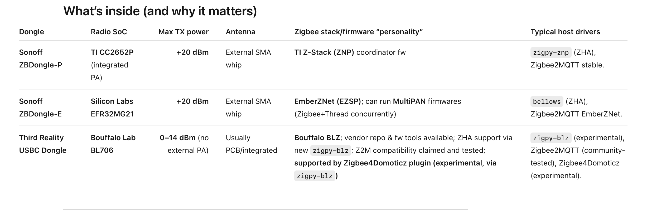

waltervl wrote: Friday 15 August 2025 18:54 Thanks, anything special with this device or just the same specs and functionality of other common zigbee coordinators?
to answer your question @waltervl I recently had a chat with a representative from Bouffalo Lab, and they're really committed to pushing out more cost-effective solutions that can match the performance of the big players without breaking the bank. It's refreshing to see some innovation in this space.
Looking at the market right now, Sonoff is pretty much dominating with their sticks, and alternatives are slim—mostly just the well-known ConBee. Remember back in the early days? There were a bunch of options like Electrolama and Elelabs, but they've all faded away, leaving us with fewer choices.
I also like the USB-C and the serial connection which is at a speed that none of the existing Dongle are ( 1 Mbauds ).
The sample I received is very well manufactured , as the Sonoff by the way. There is also a Led (like what we had on teh Zigate in the past), which give you indication of On Network, On Pairing mode, which is always a nice to have (but I also know that some prefered quiet devices )
That said, the Sonoff sticks are beasts: high-power (+20 dBm) coordinators with external antennas, making them great for larger setups. The Third Reality stick, being BL706-based, caps out at around ~14 dBm according to Bouffalo's datasheet, and it ships without an external power amplifier (PA) so far. This means the raw link budget is a bit lower, but you can mitigate that with smart placement and a solid mesh of routers to extend the range.
If you're on a budget or just want to experiment, it could be a solid pick—especially if Bouffalo follows through on their promises.
