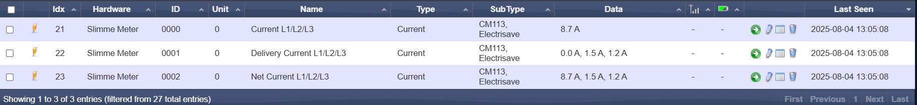

However the real values in the meter are all positive:
Anyone has a hint how to proceed, so the negative values are shown?

Anyway I think I found the spot in the code where the value is made positive again, also already created a fix. Now waiting for the sun to shine to test it 😉
If it works i create a pr
