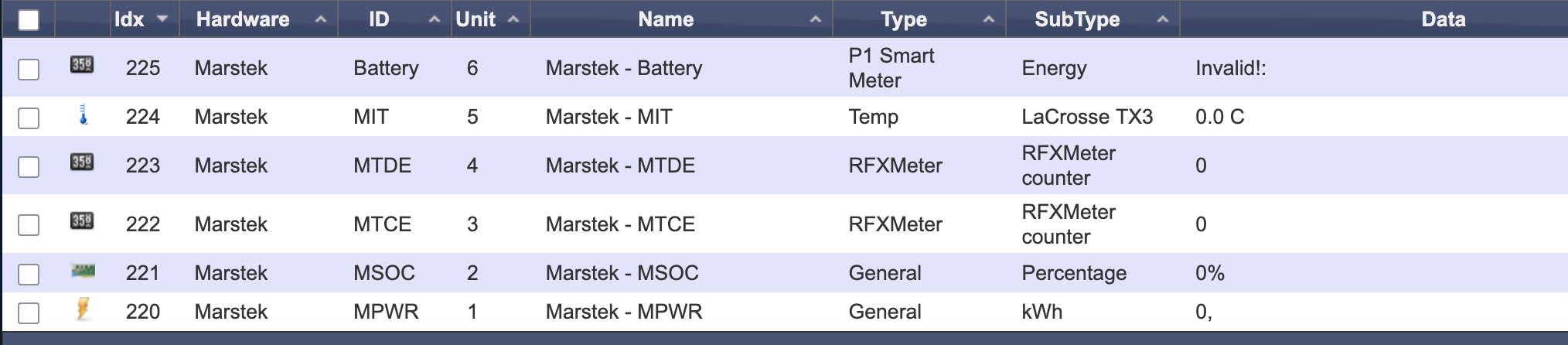

I have troubles getting the data correctly displayed and stored in Domoticz, what device should i use ?
There is no battery device available.
I have these values now :
MTCE “total charging energy“
MTDE “total discharging energy“
MDCE “daily charging energy“
MDDE “daily discharging energy“
MMCE “monthly charging energy“
MMDE “monthly discharging energy“
Because i read the registers via the DR134 it starts on a daily basis with 0.
I had several resets on the battery so the monthly and total values are not correct but from now on it should work.
The data in the Marstek app, are not available anymore when the modbus connection is used.
Thats oke for me when i can get them into Domoticz.
As you can see i get very strange data in the energy device (RFX) in integers.
I would like to see the same data as from the P1 meter : actual, per hour,day, month year; in and out.
How can i get these with existing devices or should that be made with a dzVents script ?

So today I received my PUSR-DR134
setting up needed a windows laptop here because the PUSR-DR134 default does NOT use dhcp but starts on 192.168.0.7 ...
after using the setuptool from the PUSR website on windows it is working on DHCP
following the instructions on https://github.com/RneeJ/Domoticz-Marstek worked until the mqttmapper part ...
below is the capture in mqttexplorer, refreshes every second as intended...
{"params":{"dir":"up","id":"02103225071800005978","r_data":[{"name":"batterySOC","value":"100","err":"0"},{"name":"ACpower","value":"0","err":"0"},{"name":"MTCE","value":"10183","err":"0"},{"name":"MTDE","value":"7888","err":"0"},{"name":"MIT","value":"383","err":"0"}]}}
devices are created, and not updated ...
Screenshot 2025-08-01 at 19.37.38.png (140.85 KiB) Viewed 2399 times
Marstek.json (exactly as on the github page)
        "MPWR": {
                "topic": "Marstek",
                "key":"MPWR",
                "type": "243", "subtype": "29", "switchtype": "0",
                "mapping": {"item": "params/r_data/2/value", "multiplier": -1, "digits": 1}
        "MSOC": {
                "topic": "Marstek",
                "key":"MSOC",
                "type": "243", "subtype": "6", "switchtype": "0",
                "mapping": {"item": "params/r_data/1/value", "multiplier": 1, "digits": 1}
        "MTCE": {
                "topic": "Marstek",
                "key":"MTCE",
                "type": "113", "subtype": "0", "switchtype": "3",
                "mapping": {"item": "params/r_data/3/value", "multiplier": 0.01, "digits": 2}
        "MTDE": {
                "topic": "Marstek",
                "key":"MTDE",
                "mapping": {"item": "params/r_data/4/value", "multiplier": 0.01, "digits": 2}
        "MIT": {
                "topic": "Marstek",
                "key":"MIT",
                "type": "80", "subtype": "5", "switchtype": "0",
                "mapping": {"item": "params/r_data/5/value", "multiplier": 0.1, "digits": 1}
        "Battery": {
                "topic": "Marstek",
                "key":"Battery",
                "type": "250", "subtype": "1", "switchtype": "0",
                "mapping": {"item" : "params/r_data/3/value;~0;params/r_data/4/value;~0;~0;~0", "multiplier": 10, "digits": 2}
suggestions ???

What does contain the MQTT "marstek" topic?
