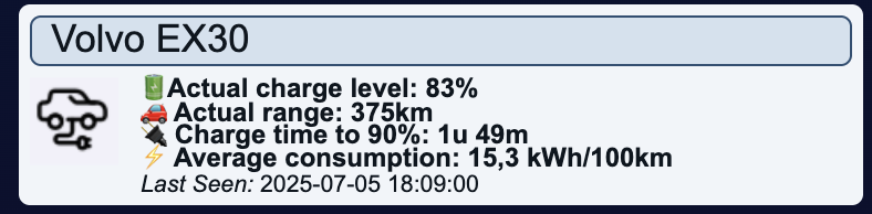

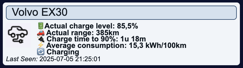

mvveelen wrote: Friday 04 July 2025 20:25 Below are the devices mentioned, in the Text device you posted. I think this is a nice way of showing these devices in one place.
I think that if I know where to start, I can manage myself to add/adjust or remove devices/lines.
"Charge level actual" is called "VolvoEX30 Batterij level" in my set up
I think "Volvo-evccConnectedStatus" (value B) is the "Plug connected"?
"Expected range" is probably "Volvo-fullRange"
"Current range" is "VolvoEX30 range"
"Charging to 90%" is in my setup "VolvoEX30 laadtijd tot vol" and I think I'd better translate. Dutch is "ugly" for these kinds of devices :D
I can't find the "Charge level set" yet.

Edit: meanwhile I managed to get some info into 1 Text device with the help of ChatGPT. At least I can fiddle with it to get the info in it I want.
Screenshot 2025-07-05 at 18.09.08.png (57.46 KiB) Viewed 3119 times

mvveelen wrote: Saturday 05 July 2025 15:33 Edit: meanwhile I managed to get some info into 1 Text device with the help of ChatGPT. At least I can fiddle with it to get the info in it I want.
Well done!
If you have a text device with more that 4 lines you can use this function for alignment.
-- Helper functions
local function spaces(count)
    return ("&nbsp;"):rep(count)
In your script
    local text = string.format(
        'Expected range %s%s km\n' ..
        'Current range %s%s km\n' ..
        'EV consumption %s kWh/100km \n\n'..
        'Charging from %s%% to %s%% \n'..
        spaces(15)..'will take %s,\n' ..
        spaces(15)..'ready %s\n',
        spaces(8), expectedRange,
        spaces(11), currentRange,
        CALCULATED_EV_CONSUMPTION,
        currentLevel, targetLevel,
        chargingTimeText,
        completionDate
Bugs bug me.

With the latest update (did the git pull), it seems to be updating the devices again.
One thing: I changed the update interval from 900 to 60 seconds to be able to see the changes faster than after 900 seconds. 60 seconds is probably a too low amount, what is the lowest one can use without getting errors? And, can this be added to a new update, so nobody can change it to a too low value? Or add a warning to best use XX seconds after testing?
Trying to figure out the status of "evccConnectedStatus"
I'm charging now and the status is now "C". When the cable is connected, but charging is stopped, the status is "B". When no cable is connected, the status is "A", so I can use this to add that info to the Dummy text device.
Screenshot 2025-07-05 at 21.25.10.png (62.29 KiB) Viewed 3083 times
