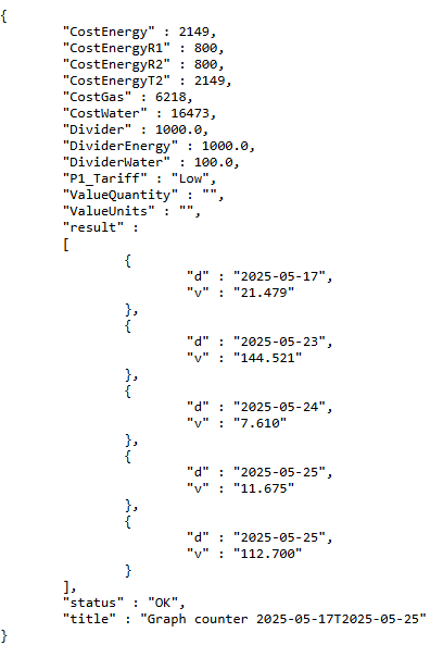

ok, so I deleted the 0 data via the json api successfully. Shows now the following on:
http://<my iP>:8080/json.htm?type=command&param=graph&sensor=counter&idx=490&range=2025-05-17T2025-05-25
Schermafbeelding 2025-06-14 215204.png (19.23 KiB) Viewed 1545 times

Posts: 6683
Domoticz version: 2025.1
Re: update historic data via api
Check the database values. I think update here means adding a row for that date as I explained before. So not overwriting the existing value. At least that is what happens on my counter device that I maintain this way.

Posts: 6683
I use the same method as you for a kwh General Instant and counter device::
http://MY-IP:8080/json.htm?type=command&param=udevice&idx=407&nvalue=0&svalue=187721000;-368000;2025-05-31
The value will always be added to the end of the table so it depends of the sorting you use when you see it.
