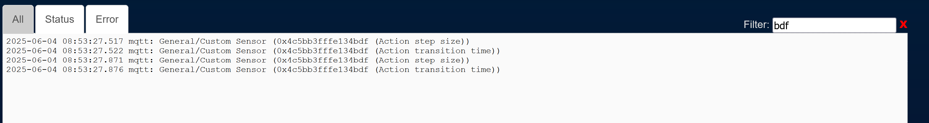

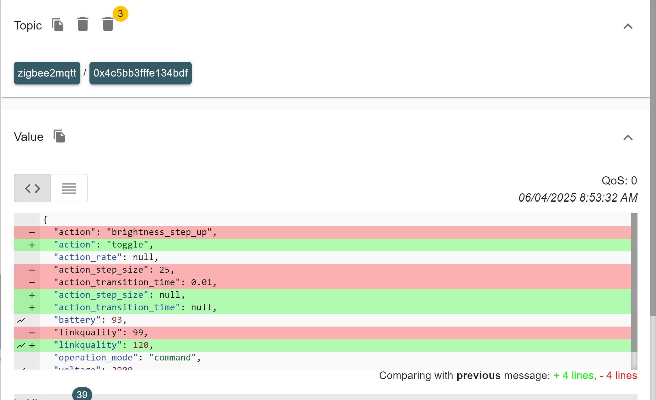

i had a look into actual messages in MQTT explorer. Here is for example i noticed same issue with TuyaKnob - some events are seen in domoticz and some are not. Rotated and clicked the Knob - MQTT explorer shows action:toggle for click but this click event is not seen in domoticz log.
At the same time other messages before button click have reached domoticz

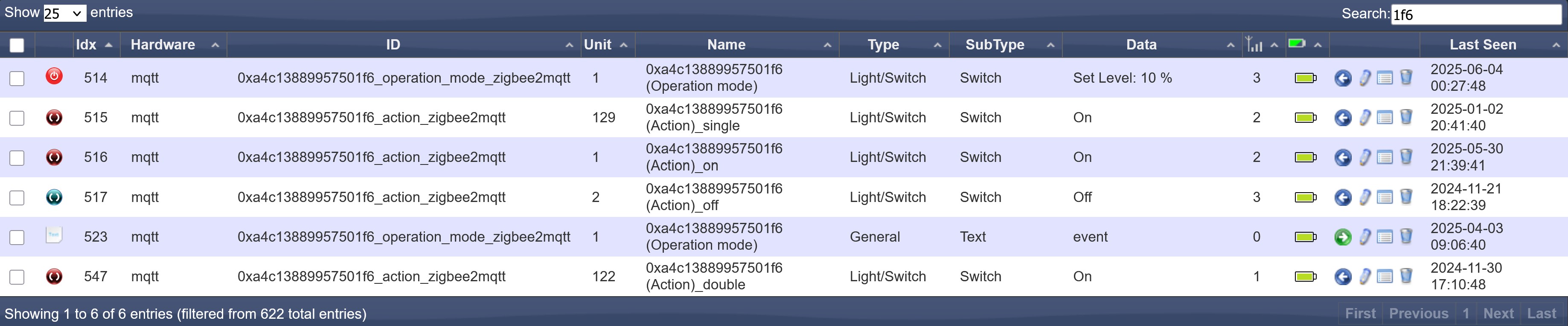

btw, here is the Loginovo button related devices in domoticz, if you look into "last seen" on the right you can see that only one device (Operation mode) event is reaching domoticz. Actions (single/on/off) are not seen by domoticz despite i see those in MQTT explorer
thanks
