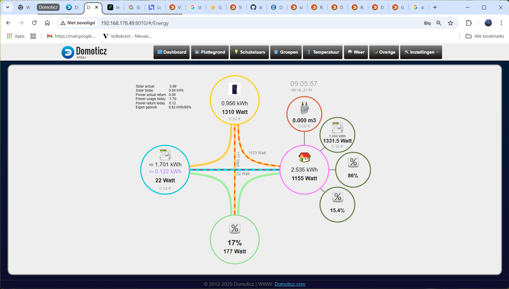

I installed the script and for nw I can follow daily own used Solar consumption kWh/%. But I like to follow a trend weekly and monthly

Hi every one, Thanks for all help.
I adjust the script "TextSensor" to % Sensor that works for me. I Used the textSensor en % Sensor devices adding to Energy dashboard. The script percentage solar panals is also working. For now I test if over a longer period .
The goal is to research the effect of the homebattery on the efficency own used generation Solar Panels. Till now the effficiency is approx 35%.
The sellers of homebattery promise up to 60%.
I will see if this is to realize
Schermafbeelding 2025-06-06 090609.png (225.13 KiB) Viewed 2615 times
