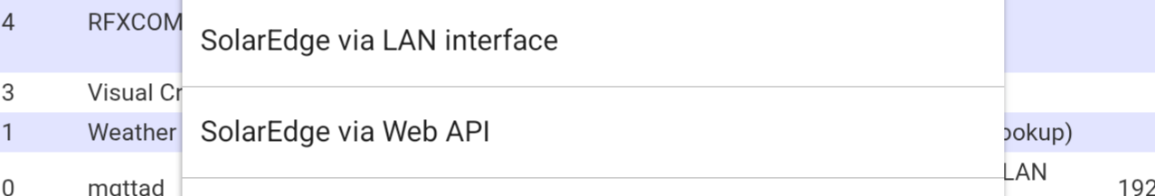

Thanks for your quick reply! I'm not quite sure if I have got you right: You say you are using "SolarEdge via LAN interface" (compare screenshot of the build-in hardware option) but refer to the plugin that creates a new hardware called "SolarEdge ModbusTCP". So I guess you are using the last one - right?

I did try "Solaredge via LAN interface" by typing in the IP (tried port 502 and also 1502) but nothing happens. Neither automation detection of devices nor an option to create devices.
Maybe an outdated hardware that no longer works?
I guess that is the reason why "SolarEdge ModbusTCP" exists.

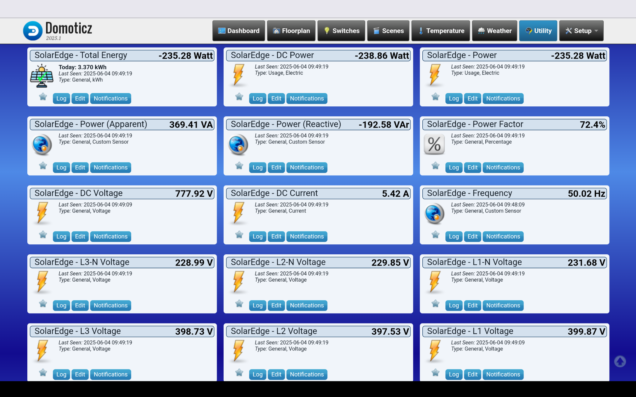

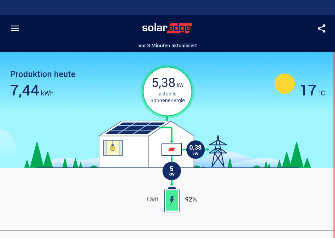

Sigh! The Power figures are much too low. What could be the cause?

I don't have the answer, i can only guess..
But could it be that in Domoticz the device Total Energy is the value of what in the second screenshot is exported to the grid? the usage/deliver-values between modbus and app can totally be different because of new 'instant' values from modbus and old 'average' values given from the app.

Re: Easiest way for a newbie for SolarEdge integration?
Update: Found the Solution in this post:
viewtopic.php?p=326370#p326370
Now the figures are correct.
Quoting the instructions that worked for me:
by jannl » Monday 05 May 2025 14:20
This is how I got the modbus connection working, in buster.
The code used runs in my customstartup.sh I use in docker.Code: Select all
pip3 install modbus==0.8.0 pip3 uninstall pymodbus pip3 install pymodbus==3.6.9
The problem for me is more computing the correct value for raw sun production, escpecially when using a battery and ev-charger. There is actually no value in the modbus registers for the raw sun production. But I am getting there and may be I will take the occasional miscalculculation for granted.
