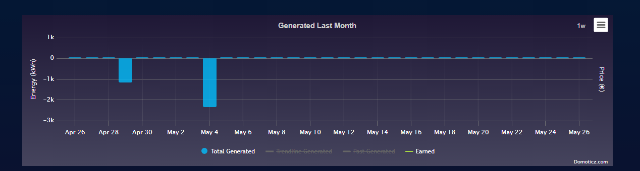

Hi All,
I have bee running my Enphase for a while now, but looks like something strange happened. I pull the data using nodered and populate virtual device.
Is has bee working great for a while but all of a sudden i do see something strange.

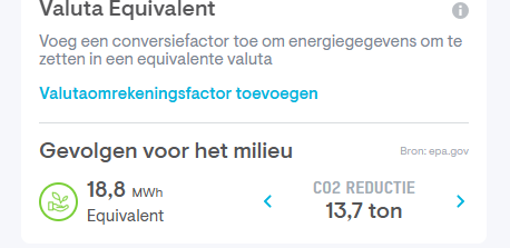

on the ENphase web site i have WattsLifetime 18.8 MWh
but in my local device i see 15.5 MWh

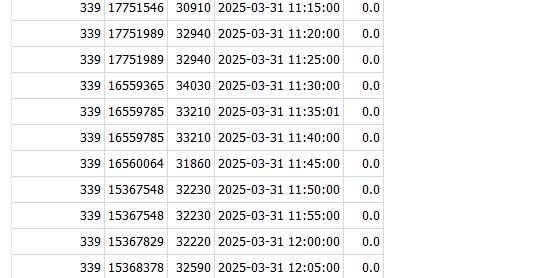

See attached what i have in Domoticz database.
which is similar to what i pul from {"command":"udevice","idx":339,"svalue":"4305;15471673"}
but there seems to be a sudden drop anyone expriencing the same?
Thanks,
Hemant
Thanks,
Hemant
Edit WaltervL: moved to separate topic as it is not related to the standard Enphase integration.

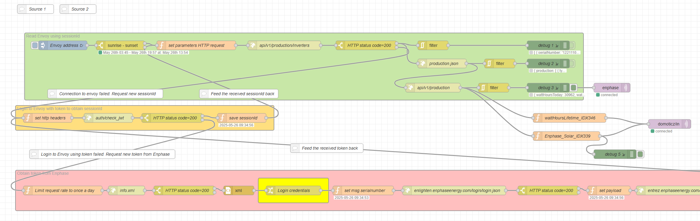

I only have 2 values wattsnow and wattslfe
below is the node-red i have been using for over a year:
msg.payload = { "command": "udevice", "idx": 346, "svalue": msg.payload.wattHoursLifetime.toString()};
return msg;
Added some screenshots, making sure i'm not crazy
Hemant
Yes this has been working for over a year.
return msg;
Hemant

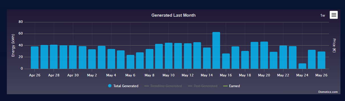

You see above the graph for April 2025 of the Node-RED sensor (which is only 4 days old) and you see the counter gives a value of 10354.198 kWh
This is not the lifetime production, as that counter has been reset in between and I think more than once.
The production between April 1-4 has been 10354.198 - 10257.721 = 96.477 kWh.
Above the graph for April 2025 of the Domoticz hardware sensor and you see the counter gives a value of 20663.436 kWh.
The production between April 1-4 has been 20663.436 - 20567.030 = 96.406 kWh.
the difference again is very small, only about 70 Wh.
But! You see that the counter of the Enphase hardware is in line with the lifetime of your installation.
It is even better than the value indicated in the Enlighten website.
So I very seldom look to the values indicated by Enlighten or the local webpage of the Envoy, but rely on Domoticz.
So it doesn't matter which sensor you compare. The result is more or less the same.
You can look up the counter value at Feb 18 2024 and Feb 17 2025. The difference is your production of last year.
But if you want to store it locally in a sensor, you can do that in Node-RED and send it to Domoticz.
See: https://flows.nodered.org/node/node-red ... nergymeter
I hope this explains something about the Enphase system and its indication.

I have seen similar issues so looking for a stable alternative, however in my case i'm also interested in the wattsLifetime and cannot use values from Enphase nor Native. so looking for something that calculates whats lifetime for me.
when i use the NR daily and look at the graph i have -2000 kwh for some days in may so, worthless at the moment.
Hemant

@herman, you won't have this issue when using the native build in Enphase support in Domoticz.

Hi Correct,
I dont' see this issue with native plugin like with NR:
However with native i don't have the Total per contract date which i has with NR but now also broken due to wrong values pushed. see earlier posts.
I want them al to work: Dayly Totals, Monthly totals and Annual totals by Contract date.
@FireWizard you don;s have the issue that daily's have strange numbers when pushing from NR to Domoticz as pervious post?
Cheers,
Hemant
Cheers,
Hemant
- Capture.PNG (40.48 KiB) Viewed 1722 times

for NR I have always used this flow:
