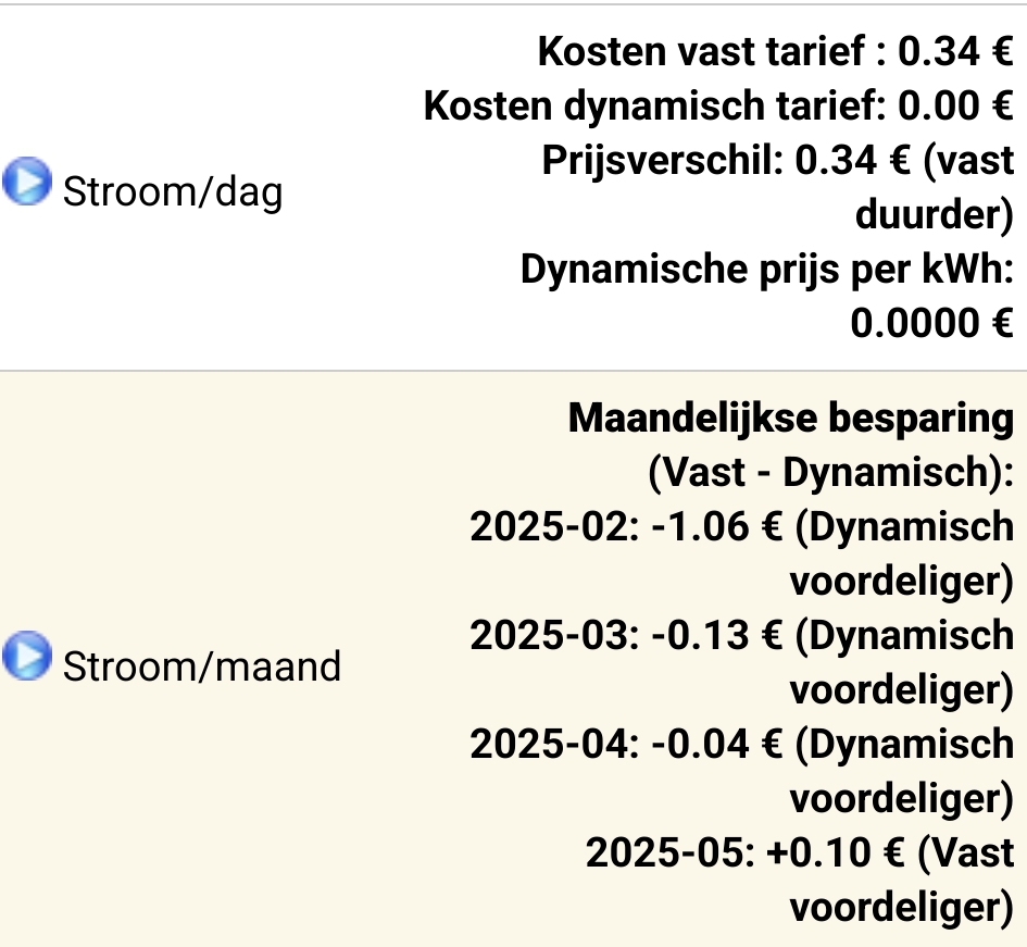

I am on fixed tariff and comparing with dynamic.
These are the results.
- normal behavior
- not accounting terugleverkosten from fixed
- no battery
- EV
When switching from fixed to dynamic I presume I'll change my behaviour.
Conclusion: changing to dynamic will bring some savings.
So before changing to dynamic there is a need for risk calculation.
What if dynamic prices rise in winter and one cannot diminish electricity consumption.
