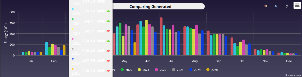

I've recently updated to domoticz 2025.1 and removed browser cache, after the update I can how hardly see the comparision pop-ups for: P1 gas, P1 power, solar production, solar radiation, etc. It is hardly visible since it it white on light grey (verified on google-chrome, firefox desktop/mobile).
Screenshot from 2025-05-12 09-37-00.png (64.62 KiB) Viewed 2098 times

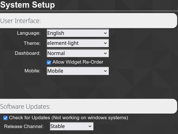

I tried to change my theme, but changing from normal to light/dark/blue not seem to make any difference.
Screenshot 2025-05-12 at 09-43-02 Domoticz.png (58.17 KiB) Viewed 2098 times

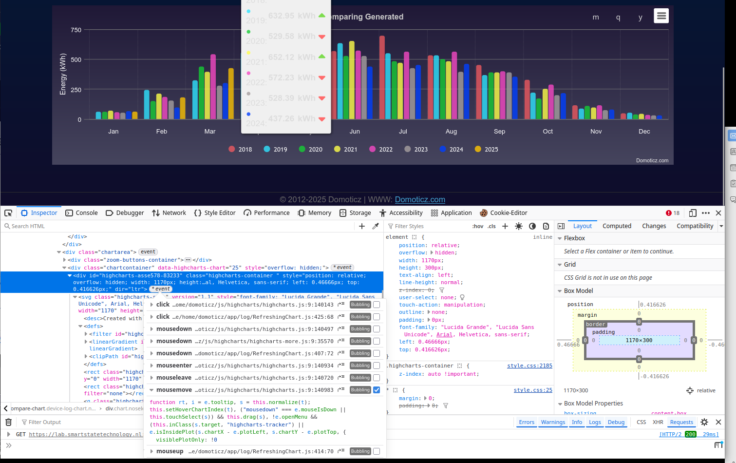

I didn't find HTTP errors in the apache proxy access logs. I used the inspector and found that the highchart tooltip is triggered on MouseMove and/or MouseOver, unsure where it gets its styling from.
MouseMove:
function rt, i = e.tooltip, s = this.normalize(t);
this.setHoverChartIndex(t), ("mousedown" === e.mouseIsDown || this.touchSelect(s)) && this.drag(s), !e.openMenu && (this.inClass(s.target, "highcharts-tracker") || e.isInsidePlot(s.chartX - e.plotLeft, s.chartY - e.plotTop, {
  visiblePlotOnly: !0
})) && !(i && i.shouldStickOnContact(s)) && (this.inClass(s.target, "highcharts-no-tooltip") ? this.reset(!1, 0) : this.runPointActions(s))
onDocumentTouchEnd

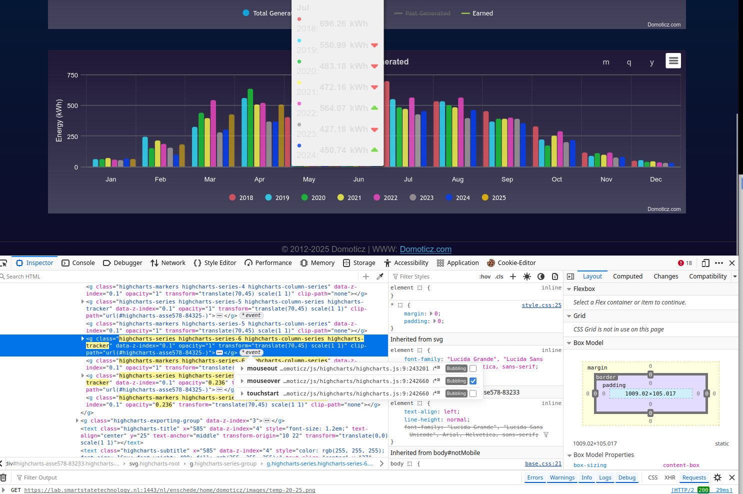

MouseOver:
function(t) {
  o?.normalize(t);
  let e = o?.getPointFromEvent(t),
    r = !s.scrollablePlotArea || s.isInsidePlot(t.chartX - s.plotLeft, t.chartY - s.plotTop, {
      visiblePlotOnly: !0
  o && e && i.options.enableMouseTracking && r && (o.isDirectTouch = !0, e.onMouseOver(t))
Screenshot from 2025-05-15 14-26-28.png (296.63 KiB) Viewed 2079 times
