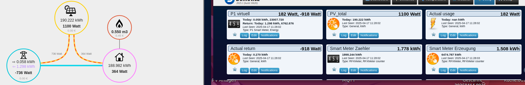

I use node red to collect data for a virtual P1 smart meter in domoticz. The values are plausible and correct in the dummy P1 device. I assume the values from my P1 meter should be equal to the values shown in the energy dashboard. For better understanding appendix screenshot. PV_total is my solar device in energy dashboard. Actual usage and Actual return sending values to P1 virtuell.
The screenshot is from the same moment as you can see of the value from PV_total. Why I got in the energy dashboard 736 Watt to grid instead of 918 Watt from P1 virtuell?

- Posts: 7024
- Domoticz version: 2026.3
Re: Energy Dashboard (Build in)
-918+182=-736

Hello waltervl,
Thank you for your answer, I understand your calculation but I don't understand why you use it.
I don't have a real P1 smart meter, so I don't know how it's working. From domoticz json/api I understand the last two numbers for P1 are for actual usage and actual return. So I interpret that actual usage is going to my house and actual return is going to the grid. I thought the minus in front of actual return is just an indicate that is going back to grid. 1100W = 182W+918W.
When I watch direct of the counter from my supplier I see 918W not 736W.
Can you tell me what actual usage and return is standing for.
- Posts: 7024
If you have 3 phase grid connection you can have for example usage from grid on phase 1 and return on phase 2 or 3.
It depends on the connection of your solar production and usage devices per phase.
Your P1 viruell meter shows "182 Watt, -968 Watt" meaning that in total there is on some phases in total 182 Watt usage and on other phases in total -968 Watt return to the grid. So nett over all phases it is 182-968=-736 Watt return. And that is shown in the energy dashboard.
Thank you very much for the explanation! I have a 3 phase connection, I just took power total from it and sent it to the P1 smart meter. So I will have a look on that tomorrow.waltervl wrote: Thursday 17 April 2025 19:35 If you have 3 phase grid connection you can have for example usage from grid on phase 1 and return on phase 2 or 3.

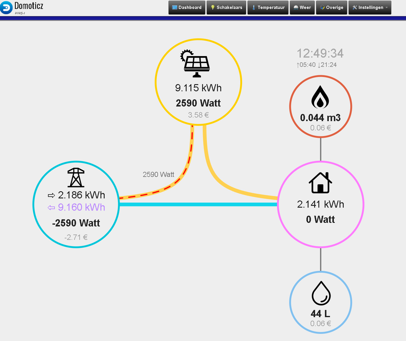

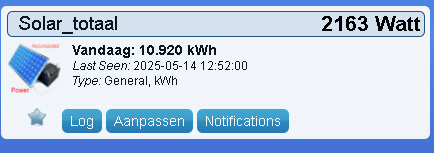

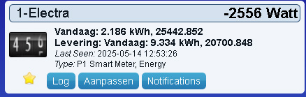

Hello, I can't find a way to place a new topic and how I have managed to put this, I can't reproduce.
But there is a new problem in my energy dashboard after the new version of Domoticz (Version: 2025.1)
My house does not get any energy as long as the solarpanels produce energy.
Looking at the devices and I see that there is flowing energy (it's obvious of course). in my house
Here are 3 pictures to show
Why has it changed?

- Posts: 7024
Seems the dasboard solar production gets the wrong data. Are the settings of the dashboard correct? It could also be a changing issue. What if you open Domoticz energy dashboard in a private/incognito browser session?

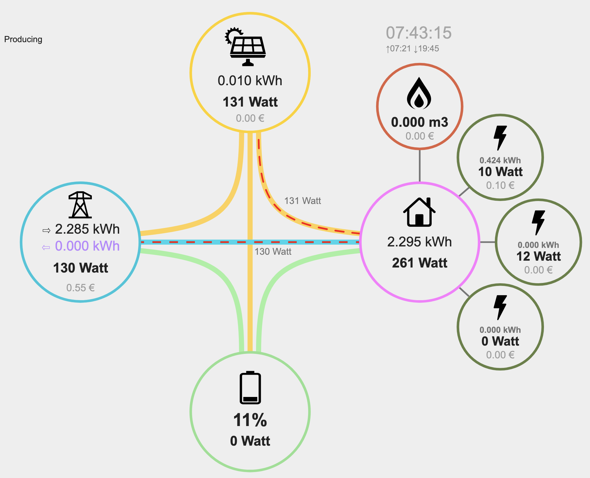

- gvandick
- Posts: 48
- Joined: Saturday 01 July 2017 12:48
- Domoticz version: 2026.2

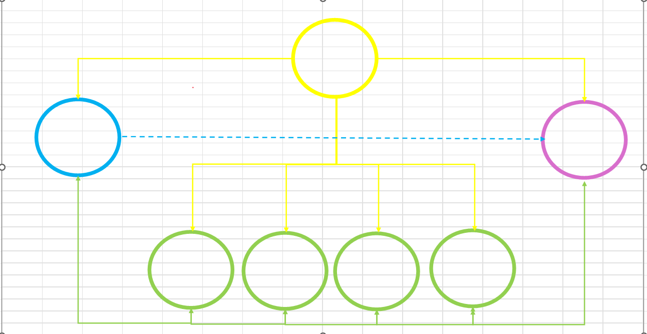

Just an idea.
I used the enegry monitor from april this year. Recently I buy a second plugin battery Homewizard. I added this as a widget to the monitor.
So I wonder if it is possible to added more batteries to the scheme with a flow.
I made a flow scheme. Most battery suppliers plugins have 4 units.

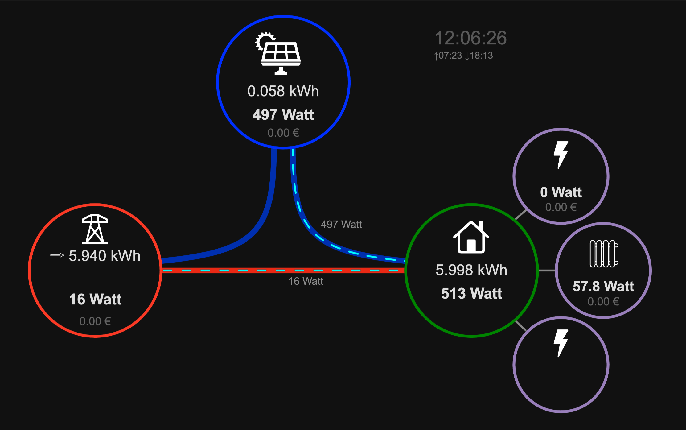

How can I invert the colors? A white background looks very ugly in dark themes.
- download.png (278.67 KiB) Viewed 4646 times
- Posts: 7024
Colors are hardcoded in domoticz/www/views/energy_dashboard.html
https://github.com/domoticz/domoticz/bl ... d.html#L79
You can modify the colors on your system, be aware after a domoticz update the colors are reset to default.

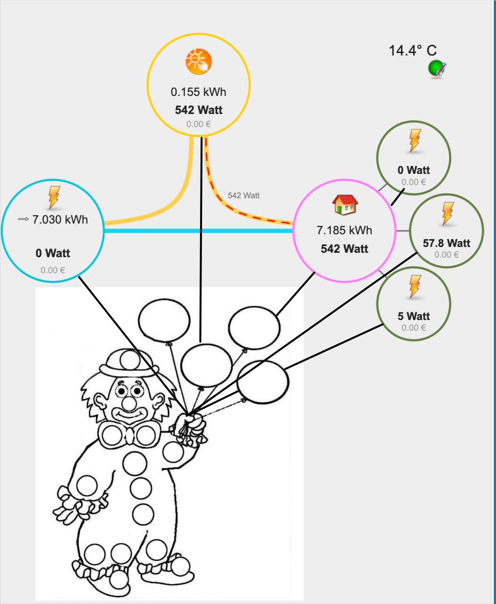

A completely unattractive image with an unnecessary menu and a complete lack of style.
- IMAGE.jpg (114.95 KiB) Viewed 4586 times
- jvdz
- Posts: 2485
- Domoticz version: 4.107
Sounds like you have some frustration and assume you will "fix" this with a nice PR that will show a shiny new page?MYXOMOP wrote: Tuesday 21 October 2025 10:22 A completely unattractive image with an unnecessary menu and a complete lack of style.
I found the source of the design and the white background. These are children's coloring pages.jvdz wrote: Tuesday 21 October 2025 11:02 Sounds like you have some frustration and assume you will "fix" this with a nice PR that will show a shiny new page?
- IMAGE 2025-10-21.jpg (87.5 KiB) Viewed 4566 times
