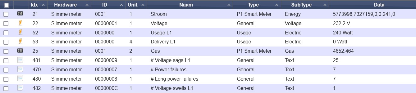

I recently replaced my P1 Smartmeter connection to measure and display power and gas consumption in Domoticz from wired to wireless.
Domoticz created new devices (with new deviceid's) in the GUI which show the desired power and gas measurements.
All working and nice, but ... I would like to keep the historic data captured with the old wired devices under the new devices.
I have about 4 years of historic data for gas and power and would like to see this data under the new devices.
To clarify, the old situation:
the new situation:
Can anyone enlight me how to get this done without corrupting the domoticz.db, for instance by manipulating the domoticz.db with sqlite ?
Or, if this has been explained earlier on this forum (I did tried searching for it): could you point me to the relevant discussion please?
