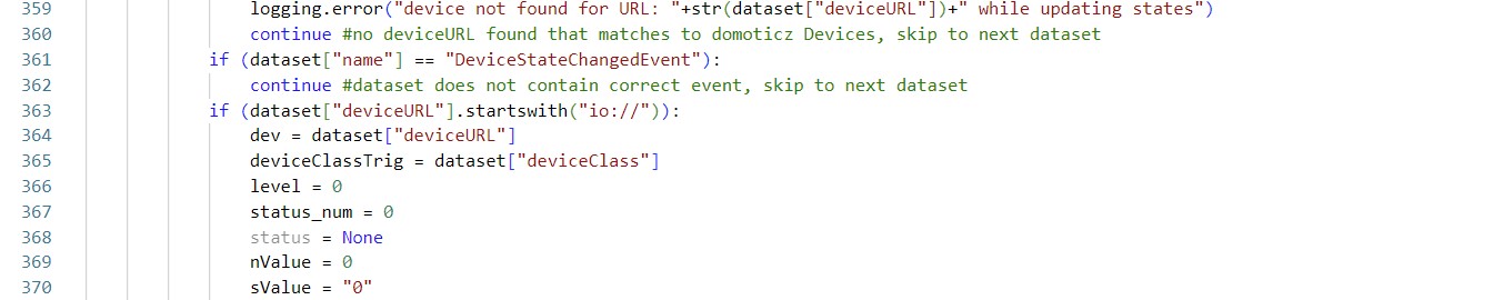

I am running the beta version of the plugin, 4.2.22. It's working fine but causes an error in the Domoticz logging (Python, key error) when one of the devices was moving. I have solved this error by modifing the plugin.py file. I have added 2 lines around line 360, see attached pictures. To use the attached file, remove the.txt extension. I am controlling 2 roller shutters, 3 screens and 1 awning, Somfy IO system. Domoticz version 2025.1 build 16675. I am running this modified plugin now for an 1/2 year without problems/ errors
- Modified_plugin.py_4.2.22.jpg (67.97 KiB) Viewed 1461 times
- plugin.py_4.2.22.jpg (77.51 KiB) Viewed 1461 times

- madpatrick
- Posts: 760
- Joined: Monday 26 December 2016 12:17
- Domoticz version: 2025.2
Re: Support for Somfy Connexoon and Tahoma
thanks
Added to the beta 4.2.23
Tip.
Better to add text is a bracket field </> then by using a picture
You can thr easily copy the text

Please check line 8 of the new beta file. It is still 4.2.22

I saw it also, Thanks
The master is now 4.2.23

There is a problem in de master version, 1 line is missing
Please add the missing line:
I tried to switch to the beta, for some reason i can't. Have to figure out why not.
if (dataset["deviceURL"].startswith("io://")):
dev = dataset["deviceURL"]
level = 0
deviceClassTrig = dataset["deviceClass"]
level = 0
