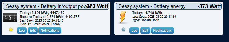

Gizmocuz I wonder about the comments. I am maintaining the plugin for the Sessy battery and created both Energy and P1 meter. The energy indeed for the energy dashboard but I like the overview on the P1 meter better:
As it states the consumed and provided energy per day.
Why do you recommend a separate meter for both consumed and provided energy?

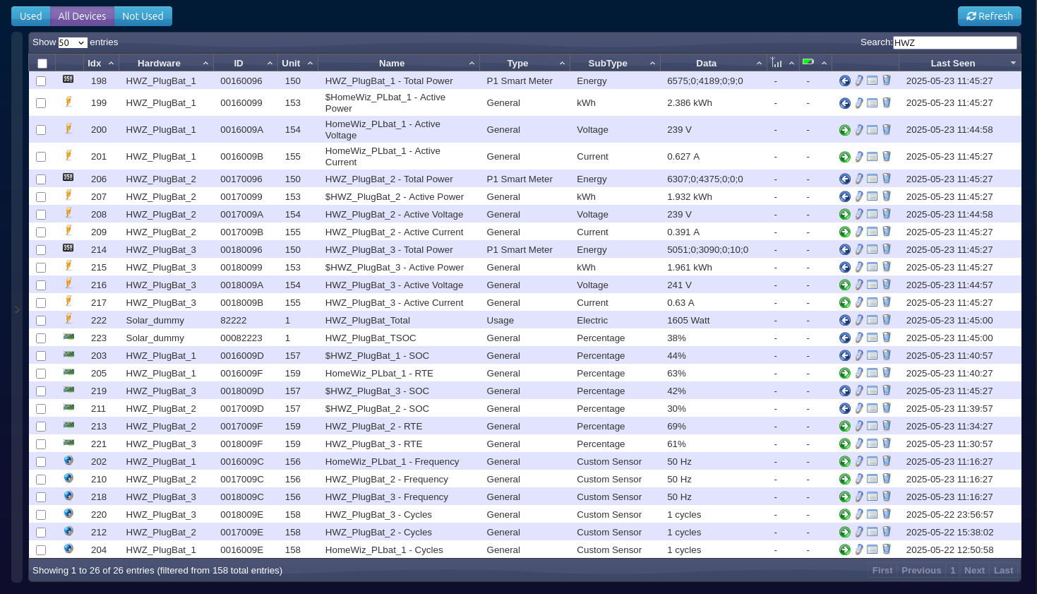

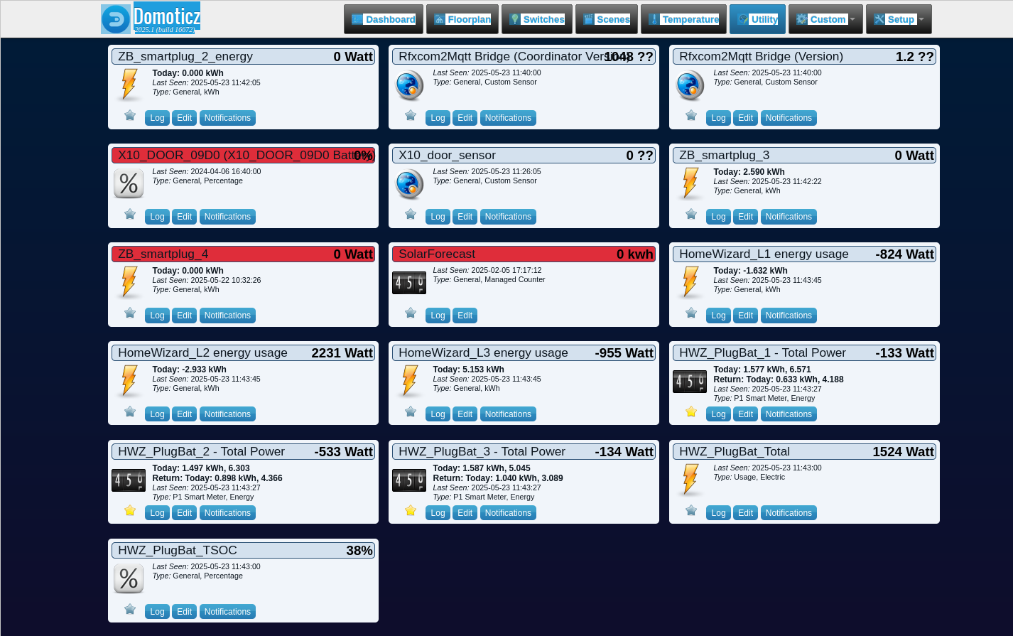

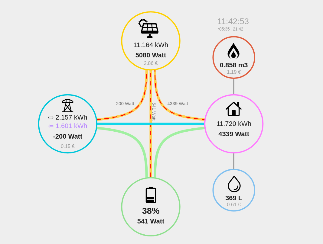

Re: HomeWizard Battery plugin
This is really great stuff. I just received 3 batteries and they work great as they were designed. However the p1-senseor is not selectable from the energy dashboard the "active power" sensor is. This sensor shows the Import-Export power of the battery. Since I had 3 batteries i had to sum them and put the result in a "usage electricity" sensor. Similar for the percentage(SOC) sensors. They can both be used in the Energy Dashboard"
Below the lua code for those that are interested:
timer = {
'every minute' -- causes the script to be called every minute
logging = {
level = domoticz.LOG_INFO,
marker = 'HWZ_plugin_total',
execute = function(domoticz, device, timer)
-- domoticz.log('Timer event was triggered by ' .. timer.trigger, domoticz.LOG_INFO)
local battery1Value = domoticz.devices(199).actualWatt
local battery2Value = domoticz.devices(207).actualWatt
local battery3Value = domoticz.devices(215).actualWatt
local battery1Percentage = domoticz.devices(203).percentage
local battery2Percentage = domoticz.devices(211).percentage
local battery3Percentage = domoticz.devices(219).percentage
-- local battery2Value = 22
-- domoticz.log('Device Precentage found ' .. battery1Percentage .. ' (%)' , domoticz.LOG_INFO)
local totalValue = battery1Value + battery2Value + battery3Value
local totalPercentage = domoticz.utils.round( (battery1Percentage + battery2Percentage + battery3Percentage) / 3 )
domoticz.log('Overal Precentage found ' .. totalPercentage .. ' (%)' , domoticz.LOG_INFO)
-- Set the value on a dummy sensor
-- local totalValue = 1
domoticz.devices('HWZ_PlugBat_Total').updateEnergy(totalValue)
domoticz.devices('HWZ_PlugBat_TSOC').updatePercentage(totalPercentage)
