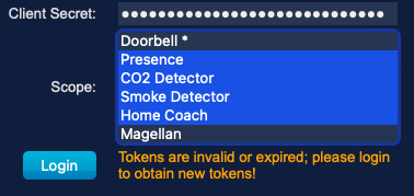

When using the latest Beta, and disable the Netatmo Hardware.
Than re-enable the Hardware and you see the blocking Error
Also on the Hardware page when you select the Netatmo Hardware you see the Yellow message that the Tokens are not correct.
Then you click on the login button.
You will see a pop-up with the redirect to Netatmo authenthication and you must agree with the Connection from the App.
After this my setup is working with all my devices.

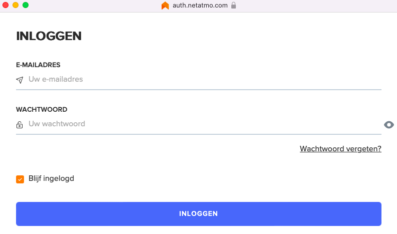

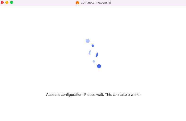

So I to make the Login procedure clear;
Login 1.png (27.17 KiB) Viewed 1301 times
Klik Login button
Login 2.png (36.29 KiB) Viewed 1301 times
Give Login from Netatmo (E-mail and Password)
When correct you see a configuration Message;
Login 3.png (26.09 KiB) Viewed 1301 times

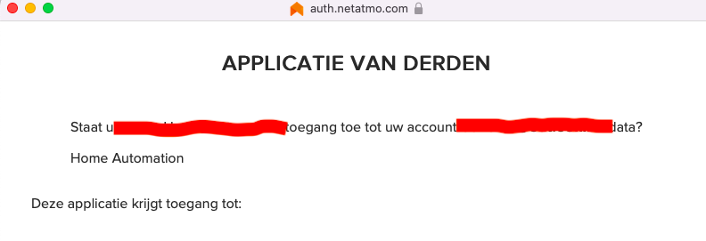

homeJLB
Posts: 121
Joined: Tuesday 16 October 2018 23:01
Domoticz version: 2024.7
Location: Belgium
Re: Netatmo authentication changes Oct 2022
Post by homeJLB »

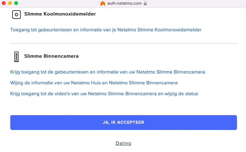

Then you get A confirmation Question;
Login 4.png (30.92 KiB) Viewed 1300 times
you scroll to the bottom and click: "yes, I accept"
Login 5.png (56.6 KiB) Viewed 1300 times
