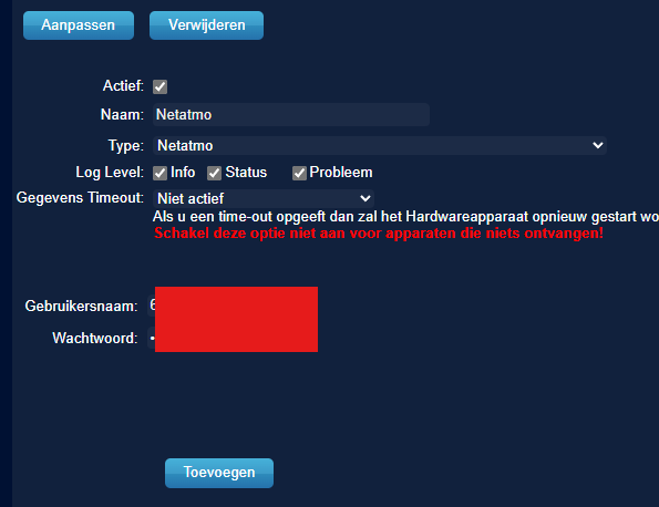

I don't have these fields in my 2024.7 version of domoticz:
