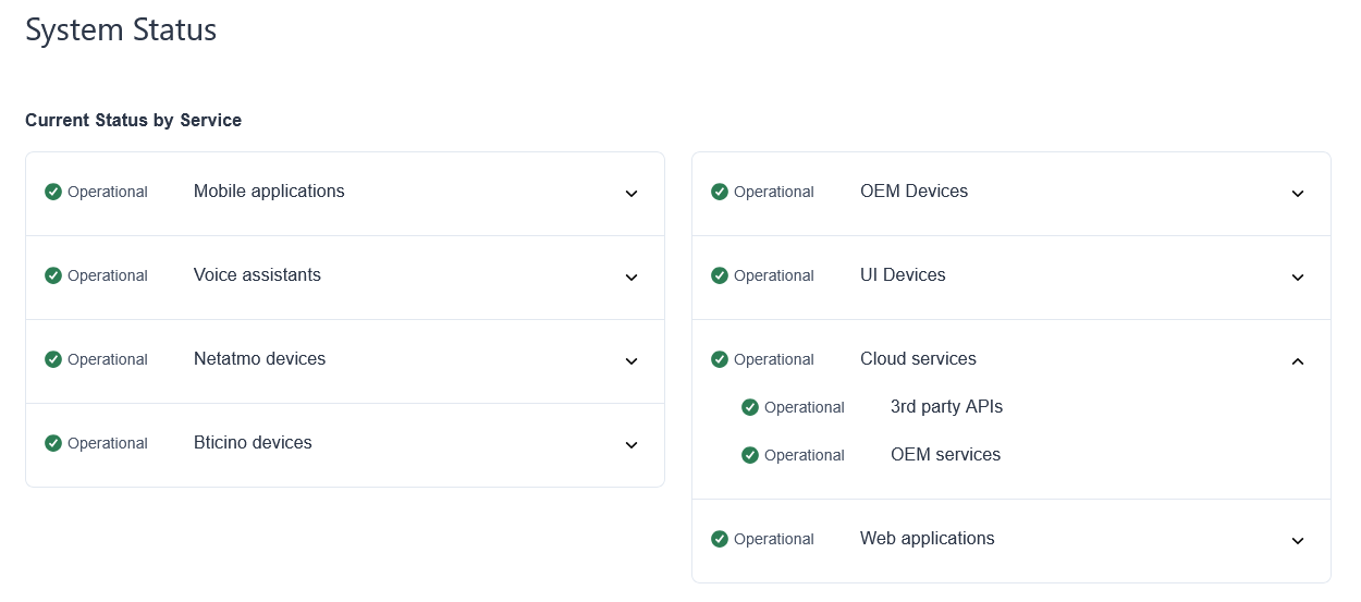

According to the current status on this page, it is supposed to be ok, but it is not effective in dz actually.
- Screenshot 2025-03-13 at 18-19-09 Netatmo cloud.png (41.61 KiB) Viewed 3126 times

But above that Status there is the Scheduled Message for 3rd party APIs.
So until that message changes, I suspect no working solution for Domoticz
